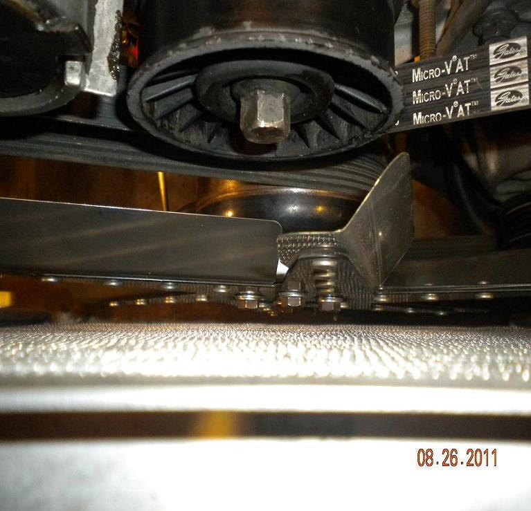

I have an F150 fead with a slim line flex and about 3/4" clearance.

Remember that a flex fan runs all the time so the motor could run too cool under certain circumstances and be it flex or clutch fan should be in a shroud and the fan should be at least 1" from the radiator.

I have the low profile one and the adaptor coming, then I can figure out what I need for a spacer if I need one at all.

I got the adaptor (Flex-a-lite 851 IIRC) right before lunch, ran home and tried it over the noon hour and I have an inch and a half between the mounting flange and the radiator. The spacing off the belt looked good but I am still waiting on the fan to make sure.
