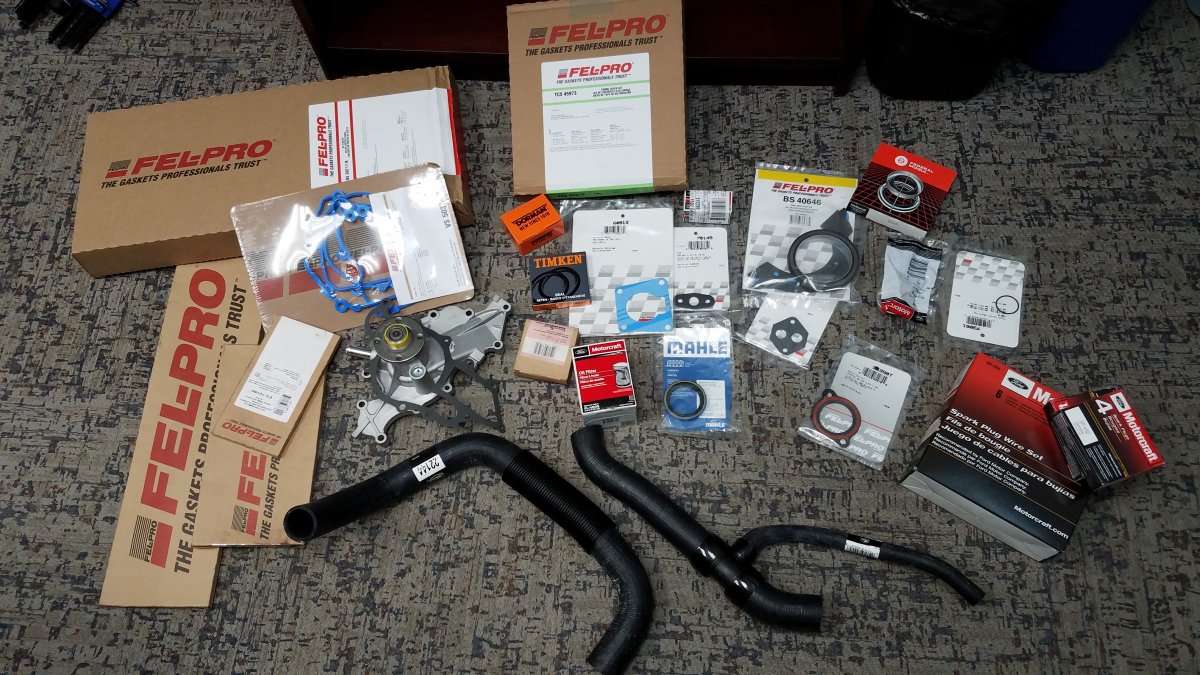

Ok the motor is coming out in a couple of weeks. Water pump, timing cover gasket, oil pan gasket, valve cover gaskets, intake gasket, front oil seal, hoses. What else while it’s handy??
If you are taking the motor out... I'd check your freeze plugs as well. Spark plugs are nice to check as they can tell you how an engine is running. Depending on where the front O2 sensors are placed on an 01, might want to take a peek as those too. Should be easier to access with engine out.
rear crank seal,, be sure to lube it to prevent dry start damage.
Still on the schedule to do this - I'm hoping two or three more weekends to get after it. I'm not driving it until then. Not looking forward to it, but has to be done and I'm not going to half way do it.
My RockAuto care package arrived. Fun for days................just need a long weekend to gitter done now.
