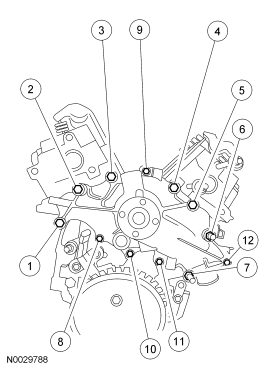

There are 10 big and 5 small bolts for the timing cover and water pump. Seven of those bigger bolts are securing two parallel surfaces with both oil and coolant channels -- in my opinion a bad design.
Follow the Ford Workshop Manual to the letters, then go back to torque the bolts again for 3 to 4 more rounds. I found that totally necessary, because when you tighten one bolt to 18 lb-ft, the silicon sealant and the two gaskets give way, making the previous bolt(s) less than 18 lb-ft.
From Engine Install section:
31. Apply thread sealant with PTFE on the bolts to be installed in the locations shown.
70554
32. Install the 10 bolts. Tighten to 25 Nm (18 lb-ft).
70555
From Coolant Pump - 3.0L Install section:
1. Position the coolant pump and loosely install the 10 bolts and 2 stud bolts.
  • Tighten bolts 1-7 in the sequence shown to 25 Nm (18 lb-ft).
  • Tighten bolts 8-12 in the sequence shown to 10 Nm (89 lb-in).
70556
