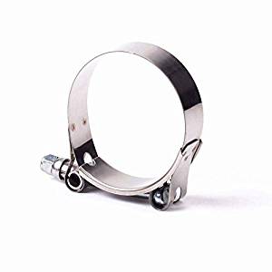

I have started using the high-end clamps with bolts rather than the worm gear ones.
Those ones are nice. I put another worm clamp on it because last year Advance switched brands on a lot of their bulk hardware stuff and I cleaned out the local store from their CARQUEST ones. I bought about 500 hose clamps ranging from1/4 inch up to 4-inch for about $12 after discontinued pricing, employee discounts, speed perks coupons and rebate gift cards that I had.
I've used worm drive clamps for decades with good results, I wouldn't abandon them just because one stripped out. Those high tech ones are nice but they're a lot more money for the same result as a good worm clamp. Being a Yankee doesn't just mean you're from the north, it means you hate to spend money unless you're getting something valuable for it.
The problem with the worm style, is that people put too much torque on them and it digs into/ruins the end of the hose. I like the OEM ones from ford that just squeeze it down. If you can get to them with pliers and do the funny little squeeze and wiggle dance, where you squeeze the clamp open, then wiggle it back an inch or so.
This is what happened to mine. I know that clamp was reused because I bought no new parts for that engine when I put it in. At some point someone, either the previous owner of the engine, or myself, over torqued it and it ate the edges of the slots, so it wouldn't hold tightly or get any tighter right there.
