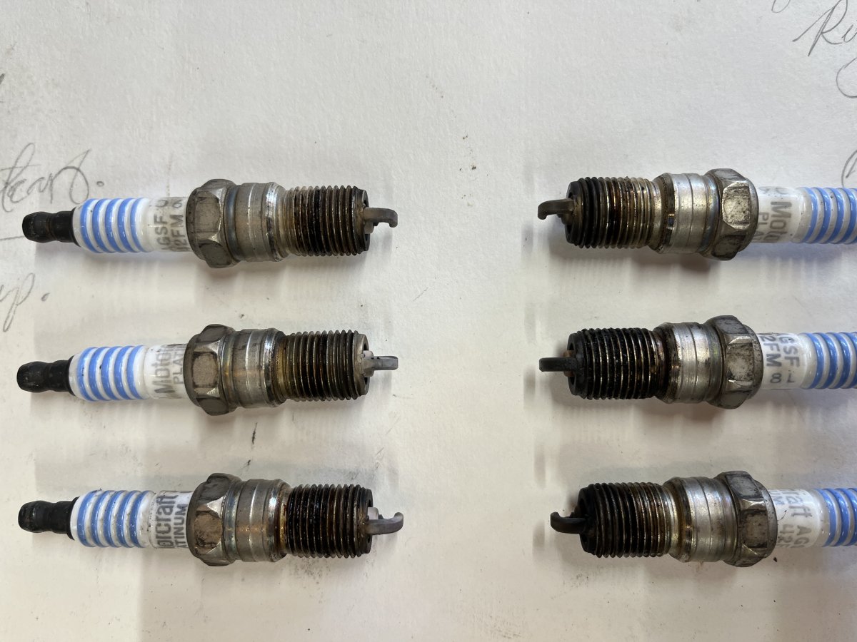

having another look at the plugs, Lower left being #1, I’d assume crack in cylinder wall between 1 and 2?

Agreed
1 and 2 look to have coolant/water cleaning happening
Valve stem seals look to be leaking on 4 and 5

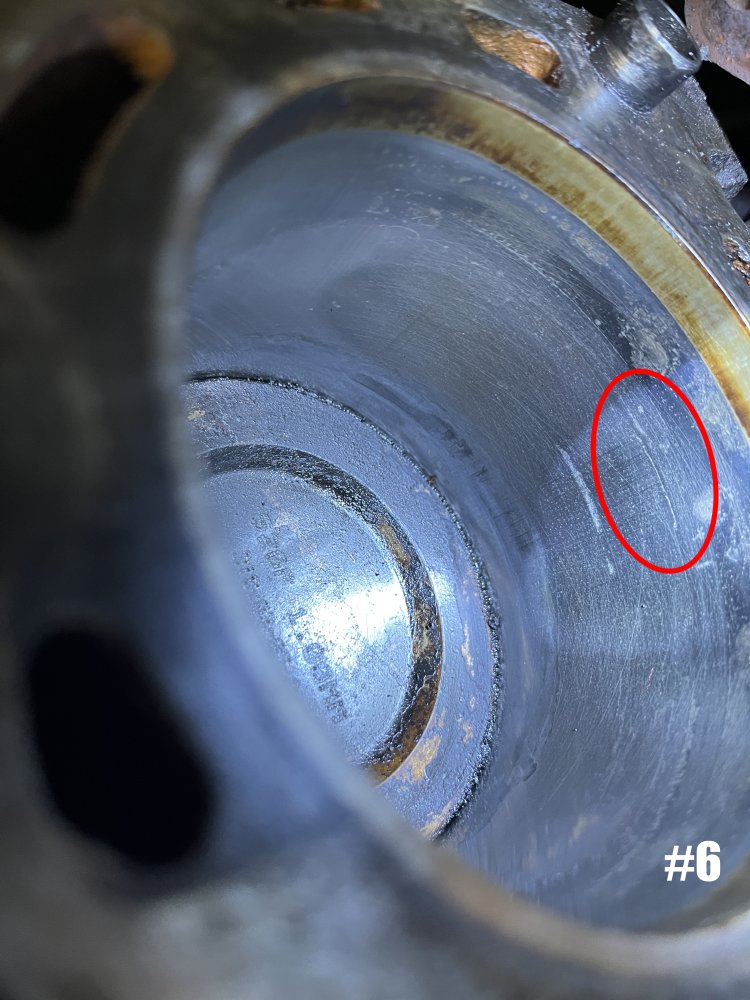

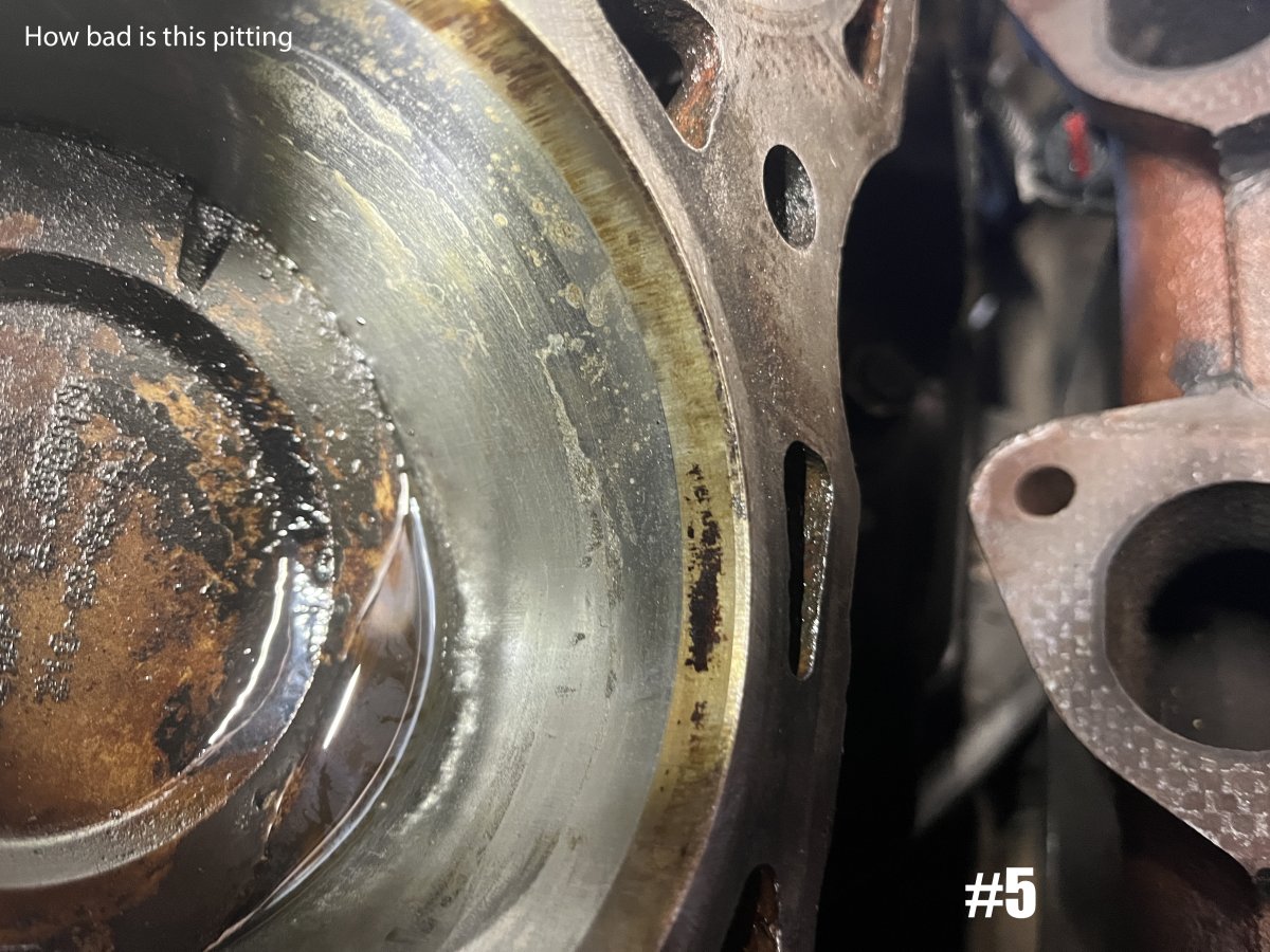

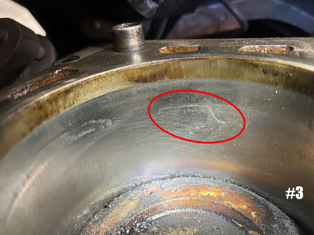

Hi friends, finally had a chance to get everything stripped away and started inspecting cylinder walls. They all (except #1) look pretty banged up to my eyes, but I haven't seen anything brand new for comparison. I visited 2 machine shops with my heads, both (upon visual inspection) don't believe them to be compromised. Should I see about re-sleeving this block? Each of the gouges I have circled, I can catch my fingernail on. These are the same cylinders that were washing the spark plugs. Otherwise, all of them are pitted and scratched, as shown.
Guessing the block has already been bored 1mm? Was every hole bored the same? Do you know any other history on the engine?
If it was mine I would write the block off and find another one unless you simply can't. 1mm is 0.040"... in my mind if you're dealing with multiple cracked cylinder walls, there is not enough meat left to tolerate heating & cooling cycles... or the block was plugged up and coolant wasn't getting to those areas. 1mm oversize also appears to be the biggest piston you can get for a 2.9.
Sleeving the block would probably fix your problem but I think it would be smart to sleeve every cylinder if they're all 1mm over... otherwise you may be dealing with this in a different cylinder in the near future. Tough call, and spendy, you would need 6 sleeves, pistons, rings, fair bit of labor... plus whatever else they find while it's apart.

I'm just assuming every hole was bored 1mm oversize at some point because your cylinder #6 picture shows 1.00mm stamped on the piston (indicating a larger than stock part.) You could look at the rest and see if they all are stamped the same to confirm cylinder diameter.
I'll have to chisel the rest of the crud off to confirm. I assume they were. I'm sad, assuming the cylinders are in fact cracked. there was a narrow window of time when this thing ran like a scalded dog. I'll rename this thing icarus. flew too damn close to the sun.
