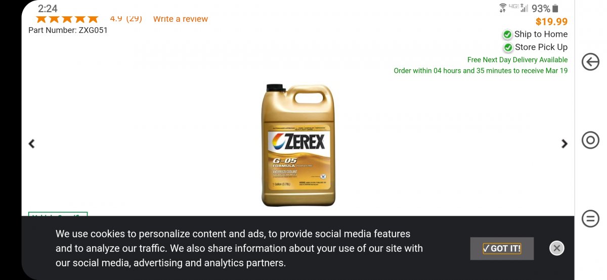

Don't put the green stuff in it, its no where near as good as the gold HOAT coolant. You do not need to buy motorcraft gold either. Zerex g05 is the same as motorcraft gold and is under 20 a gallon so less than 40 bucks to fill the system.
Just checked and its 17 bucks a gallon on amazon, 19.99 from autozone.
Do not put the green stuff in it. You do not need to buy motorcraft gold either. Zerex g05 is the same as motorcraft gold and is under 20 a gallon so less than 40 bucks to flush the system.

2 gallons of coolant mixed with 2 gallons of distilled water to fill the entire system.
Btw, motorcraft gold is even only 26 bucks a gallon on amazon so not sure who told you 100 bucks.

17.59 through Walmart with free shipping so just gonna order 2 gallons of concentrated and buy some distilled water. Thanks!
Smart plan! :icon_thumby:
