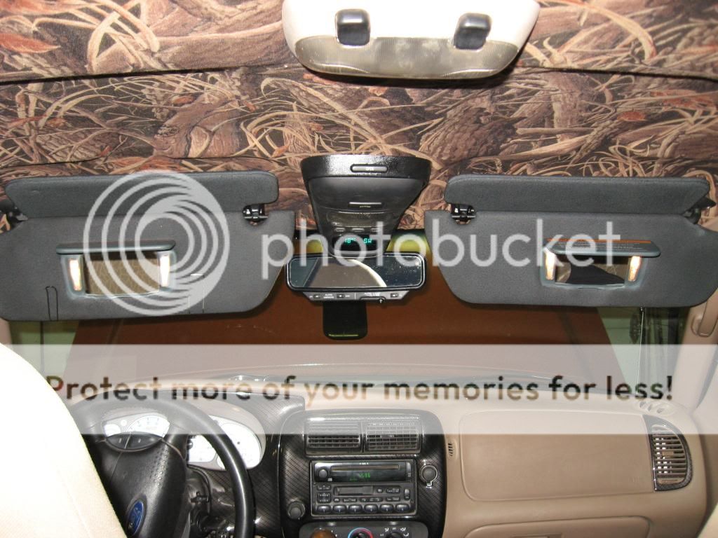

i am doing my headliner this weekend, just tearing it out and taking the fabric off and spraying 3m spray adhesive on the backing and laying the camo fabric down, i did my door sections with this iron on glue stuff, its like double sided tape that you iron on, its held up perfectly so far and you cant pull it off once you iron the material on.

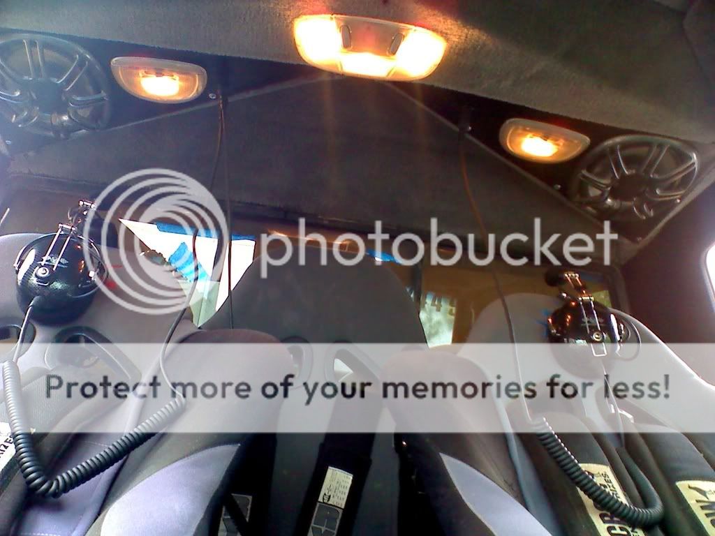

here is my trucks if u check out my sig its got my buid thread..

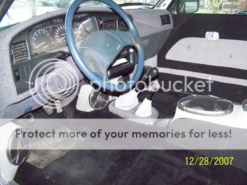

heres my old daily i built
yes i went back and installed a black steering wheel, i wasnt finished with the shift boots yet and i also painted my hood release handle
