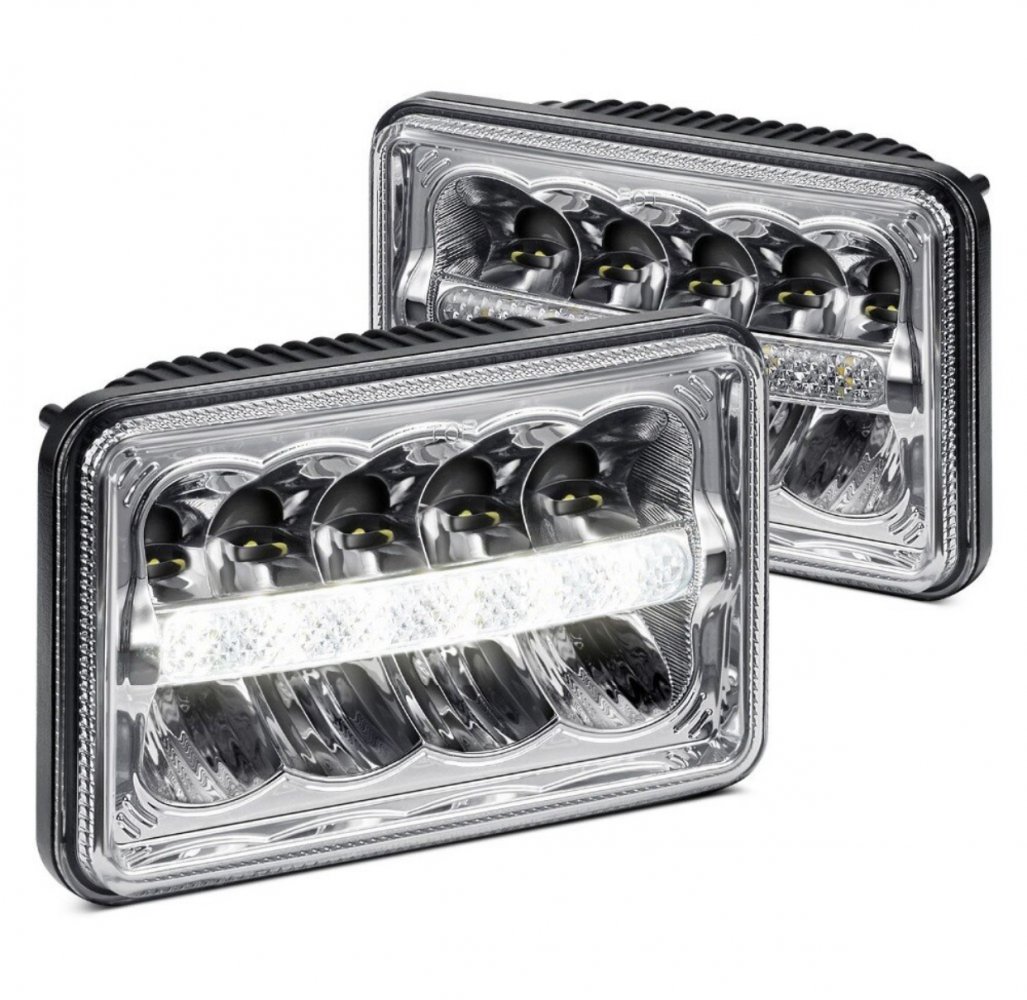

I’ve never read anything good about hi/low led bulbs in that just replace the halogen bulb. High only tend to be fine tho. My accord had led lows and a halogen high. I had a drop in led that was phenomenal. It was a regular reflector. I also read that halogen projectors don’t like led bulbs.
something like this is what I want to convert to.
Petroleumjunkie412 has something similar to those in his one truck. Those are the ones he hates. The design you post is a bit different than what he has. So, you may have better results.
