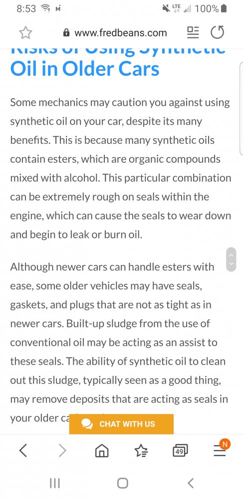

Google it. What i said is pretty easy to find across all kinds of forums. Ive even had it happen myself. Its even been covered here years ago. Has something to do with thinner molecules or better flow/cleaning properties.

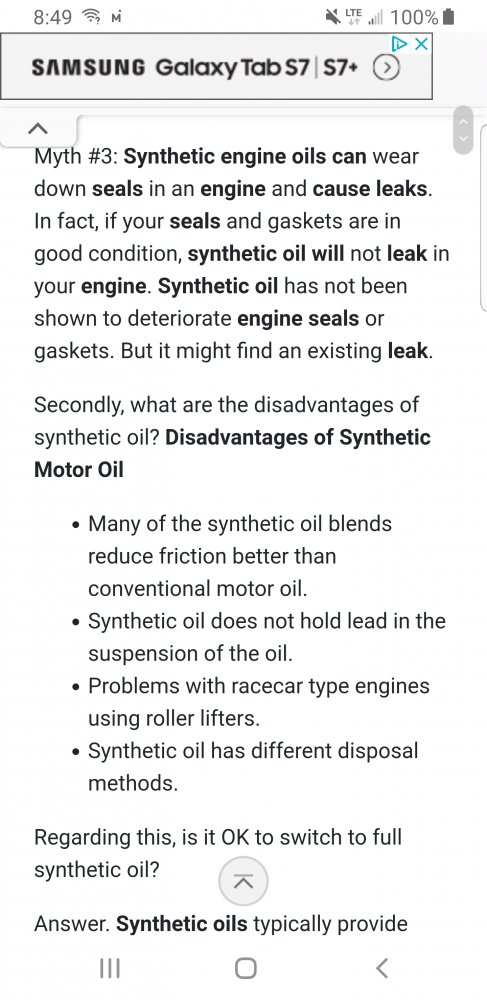

Take that as you will..."finding an existing leak"....ok well if its not leaking that bad with dino oil then you switch and it gets worse...then maybe the synthetic didnt cause it but it sure as hell aggravated it.
So do what you want OP, but i wouldnt. Rather the synthetic causes the leaks/burning could be debated all day...but it will uncover symptoms that wernt there with the dino oil.

Rusty, feel free to google 'switching between synthetic and conventional'.
In the mean time, here's an article to help you out:
Synthetic oils causing leaks hasn't been an issue since the 70's. But that's probably why you weren't aware of the change.
Like many myths, this one is based in fact. Early synthetics were made of esters, which were harder on seals, especially those made of neoprene. However, synthetic oils have come a long way since the early 1970s, and they're much nicer to delicate seals. But while synthetic oil won't create a leak, it will find one. Its streamlined molecular structure has no mercy for cracked or otherwise marginal seals. The oil and its additives may even clean deposits from the engine, which is good -- unless those deposits are acting like spackle on questionable seals.
