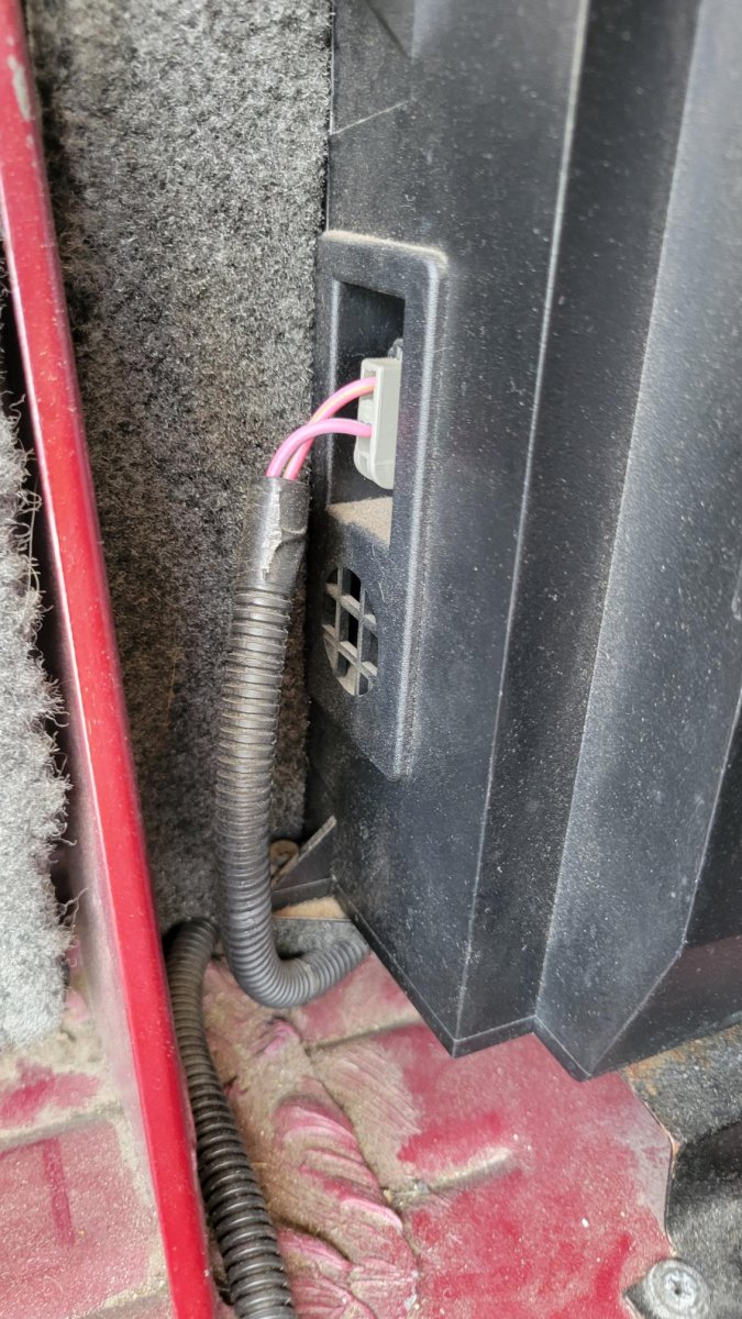

I've got a black wire and a brown wire coming from under the carpet just behind the driver seat that go to a grey connector, with two black wires coming out of the mating side of the connector. Those two black wires have been cut/ripped out of where ever they go. Any thoughts on what they go to?

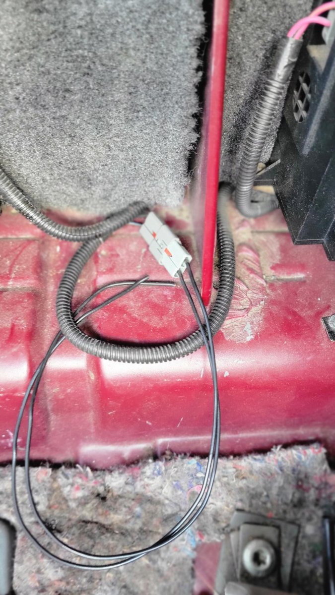

Correction, the brown wire is actually brown/lt blu. And it's not just going to a dead connector like it was a prewired option. There's a connector plugged into it with two black wires going out of it, but they're cut about a foot from the connector and I can't find what they went to.

Comes out of the back beside the wires going to the speaker boxes. Mine has a length of cable protector on the wires almost to the connector. Did you get any response at all? I just pulled my seats out and found it. A seventh speaker, sub-woofer?

your first picture I am sure is seatbelt dinger (front and center) with rear speaker in the upper right corner, 2nd pic is again rear speaker.
I'd hazard if it is 1st gen and a grey 2 wire connector under the seat it is the nag chime.
side note, later delux early explorer (like eddie bauer but ~pre airbags) have the exact same connector (they will mate) but that runs power seats.
