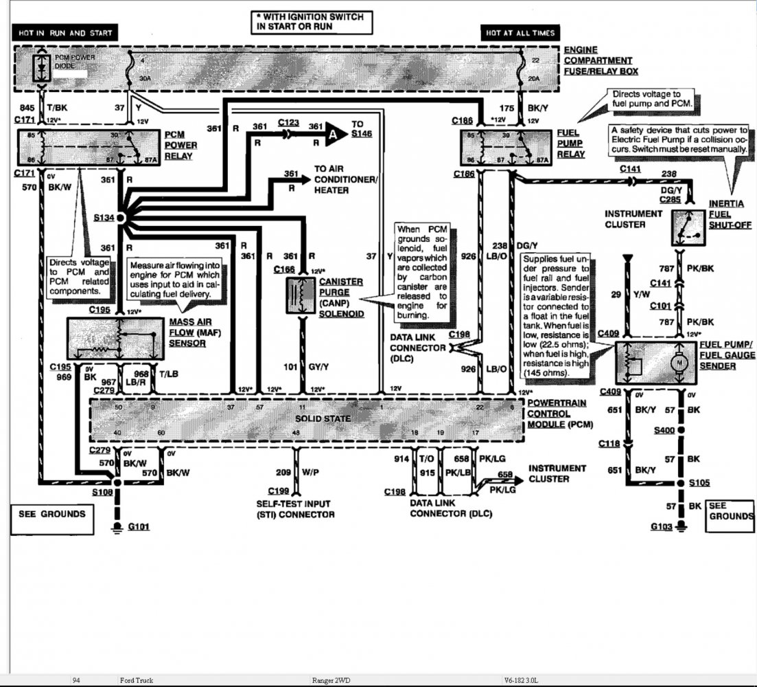

Fuel pump gets 12volt power from the fuel pump fuse and then the relay in the engine fuse box
Battery(+)----FP fuse----------FP relay-------------inertia switch---------------------------fuel pump-----ground
The fuel pump relay is controlled by the computer via it "coil" ground side
Fuel pump relays "coil" gets 12volts with key on from the EEC Relay
Computer grounds the "coil" for 2 seconds only when it boots up, then nothing until engine starts
You can cycle key off and on again to get 2 more seconds, repeat as much as you want
Key on 12v-------EEC Relay closed-----------(+)FP relay coil(-)------(OBD1)--------computer pin 22
On the main wiring harness near engine fuse box you will find the OBD1 connector
Look at the drawing here: https://www.therangerstation.com/tech_library/OBD_I.shtml
It shows the Fuel Pump slot in OBD1 connector
This slot is a pass thru from pin 22 on computer to FP relay coil, so if you GROUND is slot, then turn on the key, the Fuel Pump relay should activate and pass 12volts to the inertia switch and fuel pump
FP relay coil(-)----------------OBD1 slot---------------------computer pin 22

From description your switch is sending 12volt to FP relay's coil, and computer ground(pin 22) is working fine
(the 2second run time is from computer pin 22 grounding the relay)
Most likely the underside of the fuse box(black box) has some corrosion which can get worst and effect other systems over time, or could be just that one slot in FP relay's base/plug in
The FP Relay is not getting 12v from the EEC(PCM) relay with key on
The RED wire in above diagram that runs from S134(splice) to C186(on FP relay's base)
