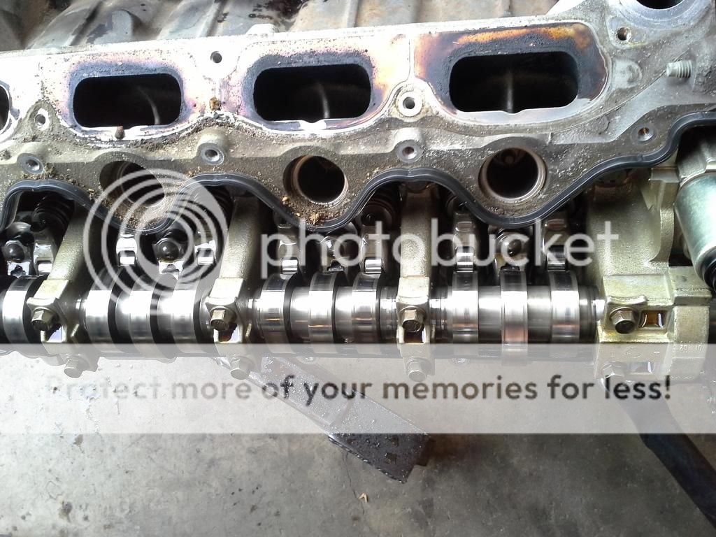

We replaced this 5.4 for a noise on cold start that we think was caused by a spun bearing. It started a few thousand miles after the guy had the oil changed with 20-50. The 5.4 calls for 5-20. We ran this oil system stuff through it, changed the oil again, and tried it. It didn't fix the noise, so we put a reman in it. After we took it out we pulled the pan and valve covers to see how well the Valvoline stuff worked.
New engine:
Old engine:
Back of a piston in the old engine:
You can see how well it cleaned the stuff out, that just wasn't the cause of the problem in this case. It might be worth a shot if you don't want to pull heads to replace lifters.
