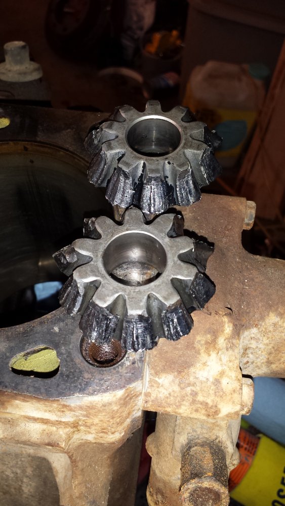

changing the pinion seal isn't too bad, but I guarantee your clunking in the rear is a worn out limited slip since you have one, this is the spider gears I pulled out of my '00 Explorer that I picked up hoping that this was the only problem with 206k miles:
As the clutches wear out the side gears move further and further out causing a decreased contact patch on the spider gears, when they get bad enough the above happens... but before that they clunk from the added backlash...
Rebuilding a limited slip isn't too bad, hardest part is getting the S spring out and back in... and hopefully the cross pin bolt isn't broken...
For the record I pulled the axle apart (you only have to pull one axle shaft to get the spider gears apart and rebuild the L/S), hosed it out with brake clean, threw in some junkyard spider gears and clutches (rearranged so it goes clutch to steel instead of stacked steels... and added one on each side) and have put over 50k miles on it towing and such, only something in the front makes noise...

Yeah, it wasn't the easiest to get it on the trailer relying mostly on the viscous clutch in the AWD transfer case for front drive... turns out the transmission was SHOT, there were some hints if I'd looked in the right place, the receiver hitch is rotated down from abuse combined with the rear diff being worn out... I put almost $2k in parts into the trans to get it functional... and like 3 quarts of gear oil and some RTV into the rear, I gambled and lost on that $800 Explorer... the $400 Explorer the wife drove for like 3 years just burning a bunch of oil was a much better deal...
I'm scared as to what my gears look like :unsure:. I have never really towed anything heavy, but it's been neglected. I will find out when I tear into it.
Your gears are likely fine, that's one of the most extreme cases I've heard of :), I have no idea what the owner before who I got the sploder from did to the dang thing but it likely takes some work to destroy a 4R70W as much as that one was...
