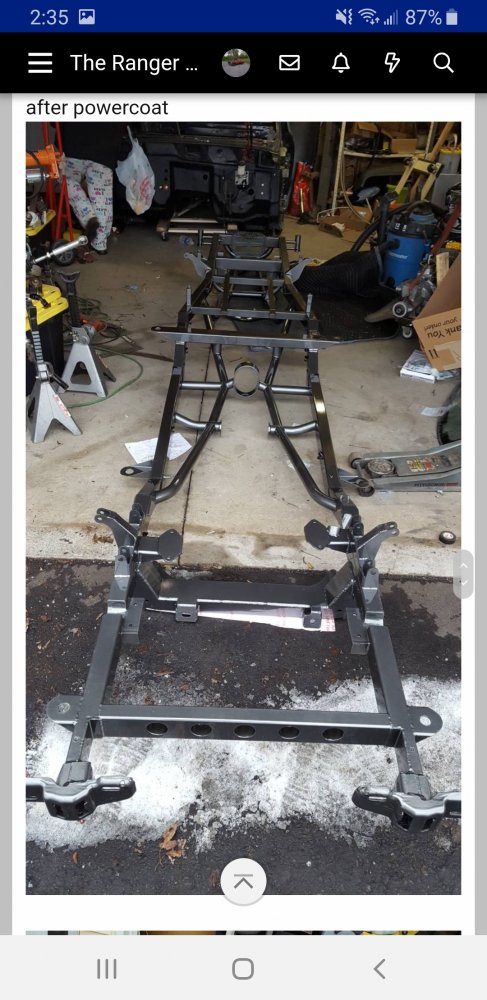

Thats what I was thinking about doing originally. I found a thread a while ago where the guy built this.
52676
But there wasn't any detailed measurements in the thread.
