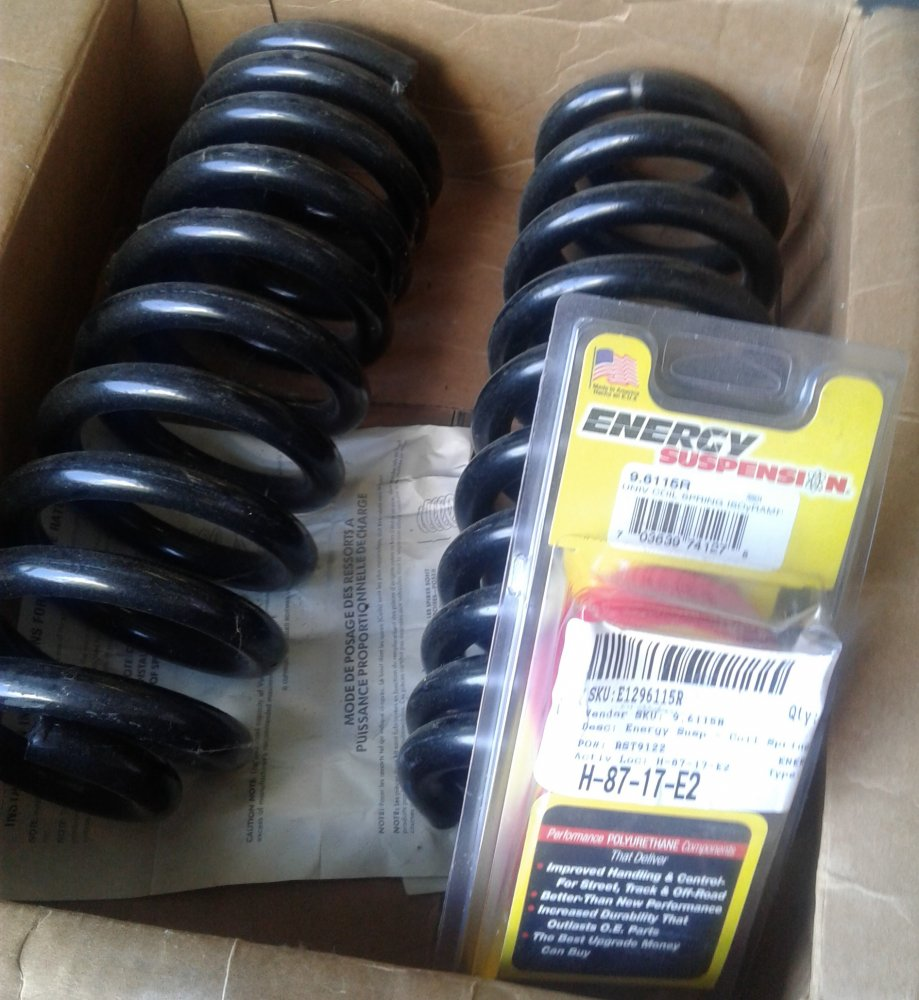

It's the same number as the link I posted... with an R on the end to indicate Red in color.
61600
I looked at energy suspension and searched E1296115R but it didnt come up with that part number as a fit for the 1987 ranger 4X4 2.9
search 9.6115
So the E1296115R energy suspension isolators will fit the FOTZ-5A307-A (OEM) seats, correct. Dirty
I bought the springs and isolators for my 94 4.0L with a D35. You're asking my questions that I really can't give you a positive answer.
In the link I posted it has all the dimensions listed... you will have to measure I suppose.
I went to energy suspension web site, good stuff. They got the front sway bar bushings i need but cant seem to find the correct Isolator and seat from them. I PMed them, waiting for reply. Thanks Uncle Grump. Don't know if those springs will fit my 87 those are for a 94 with a D35, mine is a D28. Is it 4X4. Think the 2wd and 4wd have a different set up for the front end?

That's what i have, Waiting on isolators from energy suspension. That tech there got the part and measured it for me. Its 3.070 OD, 1.75 ID 5/8 H.

Most i can get is 1 inch of washers on the stud
these isolators are hard to find but not impossible, seems Moog is the manufacturer for the OEM isolator and seat. They fit perfect in the OEM spring and seat.
