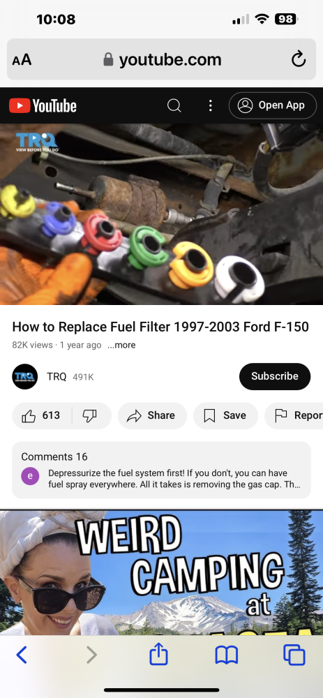

Well I tried to pull the filter yesterday (didn’t have new one yet, Napa walking distance). But after finally figuring out those retaining clips I couldn’t yank the hoses off. Turns out there’s a special tool for that?
The special tool is for fittings at the engine and maybe fuel pump. The filter is just remove the clips and pull. It may help to get some spray cleaner (carb, brake, doesn't matter) and spray into the connectors. They tend to collect dirt/mud. After you get them as clean as you can, spray with some kind of penetrating oil. Then work the ends loose wiggling and rotating as you go. If the filter is like mine, it's held in by a hose clamp like fitting. Loosen that and turn the filter inside the lines if you can. Be careful not to twist the lines though.
Ok, I was able to twist the filter around on the hoses, just couldn’t yank them off. Then saw this video of a guy using the tool so I stopped.

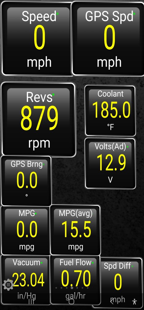

Did you check your vacuum? I'm curious to see what you're pulling, and if it is steady or bounces around.
I'm seeing 21-23 in/Hg at idle of 800-900. Used TORQUE on Android and a Bluetooth OBDII connector.

Just looking at the data... battery voltage while running should be about 14 volts.

I had all electrical/headlightson hi/ac turned on to see where idle sat after cleaning iac.
I'll run another with no power drain and double-check.

Hmmmm. Warm engine at idle and only 13.1 volts. Will now test the alternator. Thank you for pointing that out Uncle Gump! I have not had any battery problems SINCE I added a solar cell in the back window (I added a solar controller too). But the battery would go dead after about a week if I didn't drive the Ranger before I added the solar cell
That mpg is a lie too. Have not tweaked Torque to the truck yet.
I finally got back to this. The volts appear to be controlled at the OBDII connector. It never goes above 13.2 or so. I put a voltage meter on the battery, and while the OBDII shows 13.2, the voltage at the battery is 14.4.
