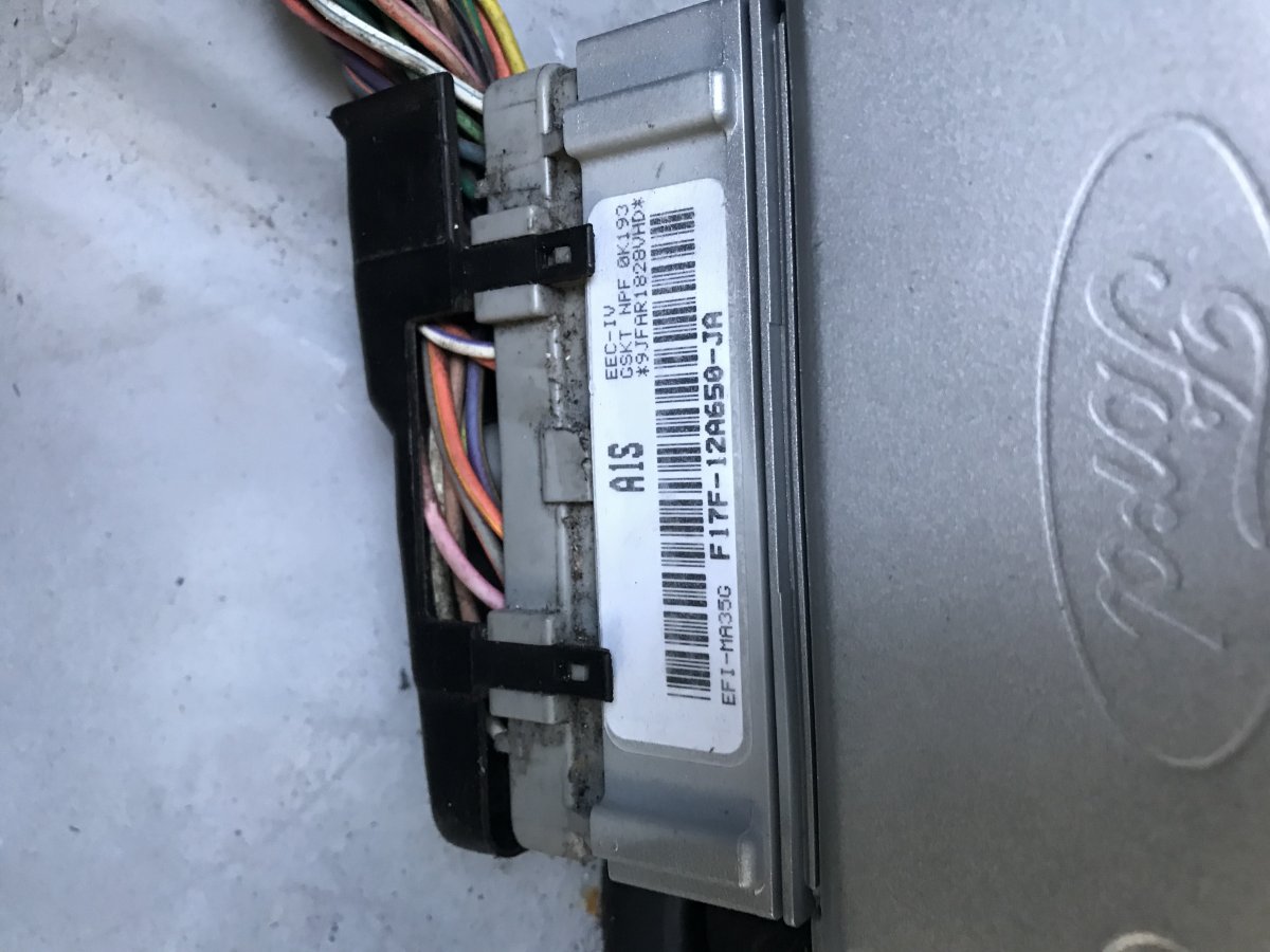

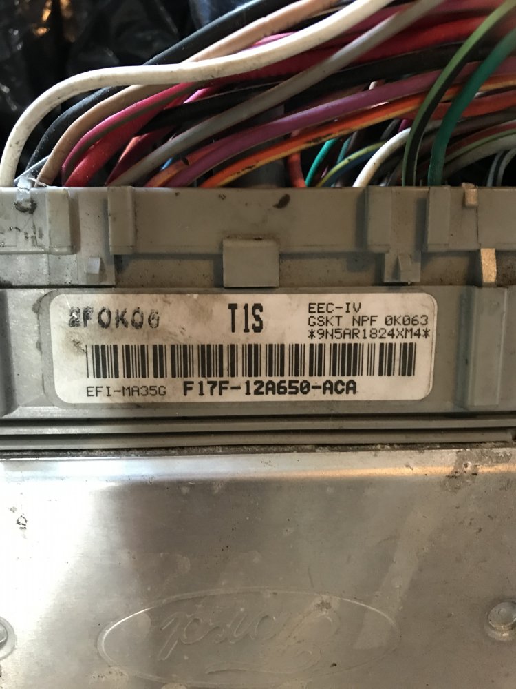

This the PCM? Not sure if its correct. The spark plug wires are brand new and yes they are in the correct place. whats weird is the motor runs smooth and perfect till over 3000rpm in 2nd gear and around 2000-2500 in 3rd gear. I can short shift and roll on the gas in 3rd at 20 mph and its super smooth and has power, but 2 seconds of that power and RPMs climb and then drops out.

thats the edis ignition module.

Bobbywalter: Pics are of old PCM from auto, and the new PCM I ordered and are currently using.
franklin2: I will check and do everything you wrote about.

I need to try to run the cc on the PCM you posted to see what it is supposed to be.
No telling what it actually is.
