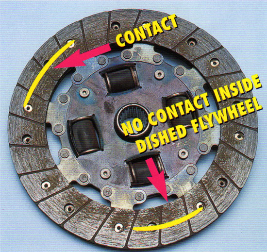

Only way you could find out is unbolting the tranny and separate it a couple inches and maybe take a peek at it and see if it does need to be replaced. Plus you would have to take the transmission completely off to replace the slave cylinder anyways. I also replaced my flywheel too. If the teeth look chipped or damaged, that would be the time to replace it while you have the tranny dropped. Flywheel costed 60 bucks.
Ignore the first sentence, I was having a stupid moment lol. But the way to know the damage on the clutch is seeing if the ridges were worn down all the way down to the plate. That is a sign that it needs to be replaced.
