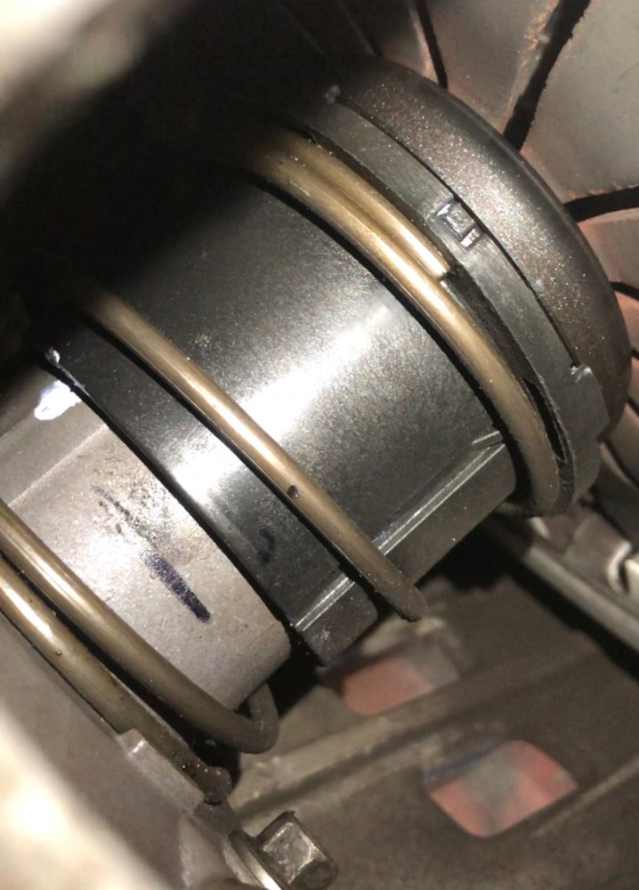

Having an issue with my clutch! Just need some opinions before I tear into this and replace the clutch disc and pressure plate. Im getting approx ¼” of travel in the Throw-Out bearing. Attached pic shows travel of T/O bearing (from the black line).
Question: Does the T/O bearing travel look normal, or should it be more? Needing a new clutch disc after 15K miles doesn’t seem right but maybe that’s what happens with cheap parts?!?!?

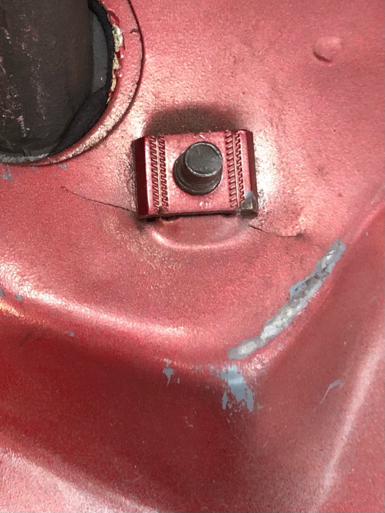

Finally had some free time this past weekend to troubleshoot my issue. What I found was that there is a crack starting at the lower Clutch MC mounting bolt. This results in the MC flexing about 1/8". From pic you can see where the pedal hits the firewall when fully depressed. The worn spot on the mounting bolt explains why at some point during the last year my pedal was getting "hung up" when fully depressed. It must have been hitting the side of the welded nut which was causing a dead pedal feel when released. Anyway, I ended up grinding about a 1/4" off the bottom of the pedal lever (where it was making contact with firewall) in order to make up for the flex. Didn't do any good. I believe my clutch will need replacement regardless. However, I still need to address the crack! Did you end up welding yours back or did you come up with a different fix? I will probably start up a new thread on this if I don't get any solutions from this one.
Lower Clutch MC mounting bolt looking from the inside of vehicle.
weld and plate.....or just plate....
