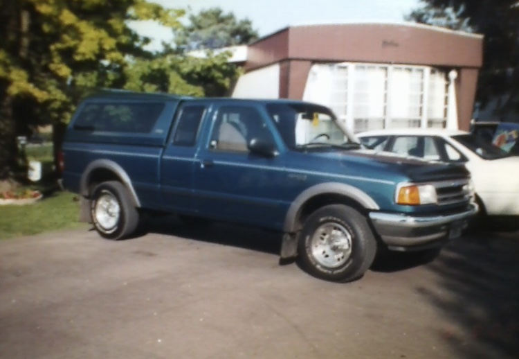

that was almost 9 years ago. I don’t really remember much about that day. Miss that truck, my favorite ranger & favorite vehicle overall. Welcome to T.R.S.
