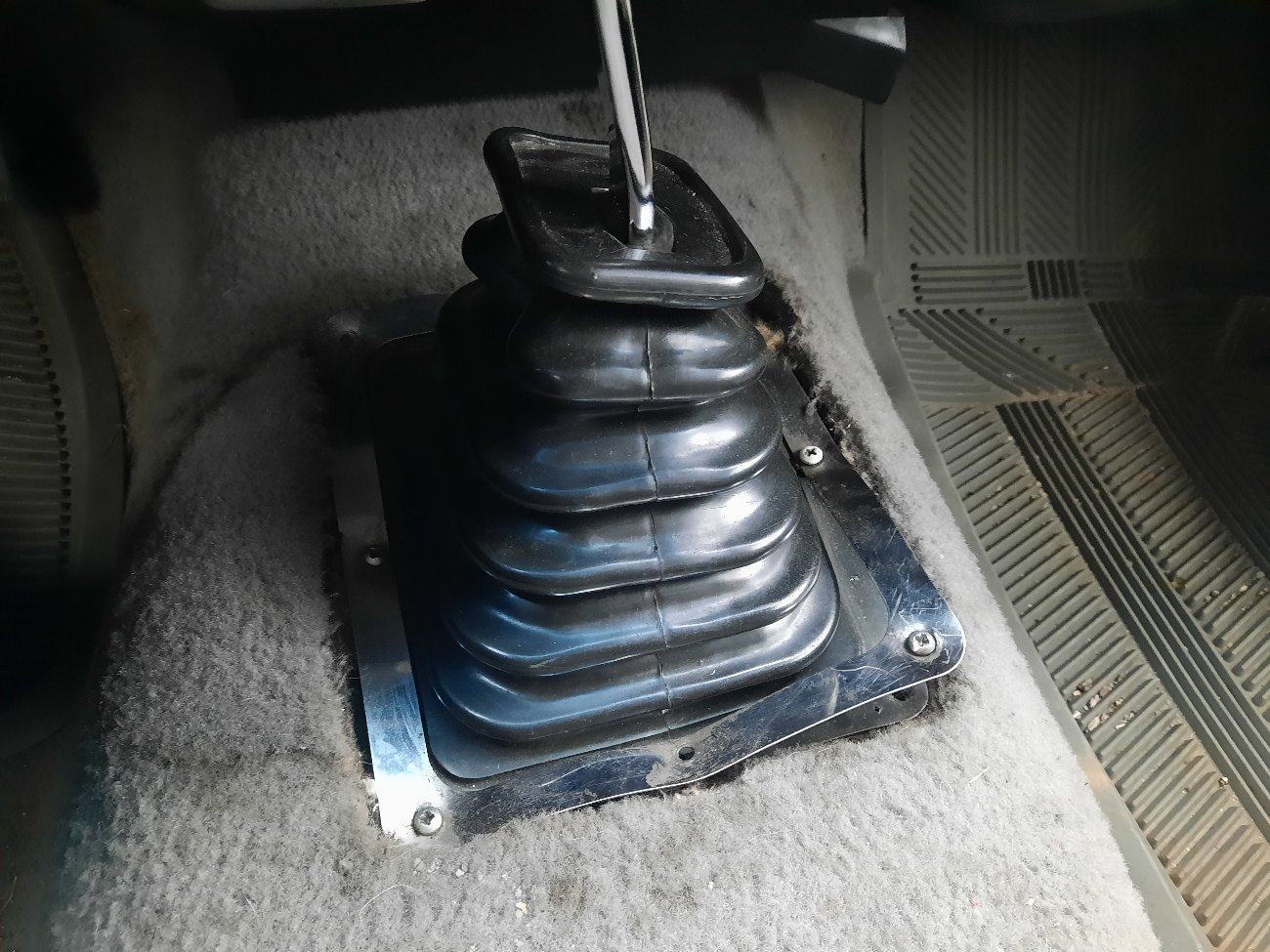

Rhythmic clicking noise. Easy to hear in the cab. Does not sound like marbles in a can or buzzing.
Three reliable ways to reproduce the sound:
  • In neutral, while stopped, carefully hold RPM around 1100. Sound starts at ~ 1000 and stops around 1200. Regular clicking, but subtle.
  • While driving normally or accelerating firmly from a start, sound starts between 2000-3000 RPM and gets much louder, but not faster. The sound competes/mixes with the exhaust note. It's not drowned out, and my exhaust is loud.
  • On the highway, around 65 MPH in fifth gear, sound starts when I ease off the throttle slightly. Goes away with increased throttle pressure (even though RPM not changing appreciably). Heard clearly over the road noise.
Some notes:
  • Custom 3" exhaust.
  • Flex pipe on the driver side, but I don't see any on the passenger side.
  • No heat shields, but good clearance, including around cross member.
  • Transmission mount in good condition.
  • No witness marks I can see on or around the exhaust.
  • No changes when clutch disengaged.
  • Sound seems loudest at the oil pan.
  • Truck has a poorly installed Hurst shifter with a gap at the boot, so I tend to get lots of transmission and engine noise in the cab.
Only had the truck for about a month. No idea how long it's been like this.
I'd be looking for an exhaust leak.
Make sure you don't have any "friends" nearby when you're listening for the noise.
I'm starting to think this is my real problem.
Covered this up with a heavy towel, went for a drive, and OMG. Nearly all the road noise, clicking, and whirring goes away. I think if I had a properly installed lower boot, and a factory shifter, I'd have no idea the clicking was even there.
