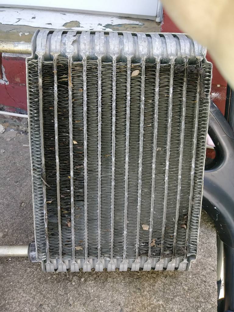

No way it's easy! If you're going to do it you may as well completely do it like we did when we replaced the evaporator in my truck which is a 94 supercab. There are stud bolts on the firewall and the heater compartment

Nice pictures and great replies!! I've swapped my entire r12 system for r134a about a year and a half ago. Everything is new except the evaporator. Blower motor is new too. When I replaced the blower, I only cleaned hand deep, which wasn't too bad. I was just an amateur when I replaced my ac, now I'm an amateur that knows a little more. Ac blows fine, no funny smells, I just like to keep up with my truck in anyway possible. She's been good to me so I'll be good to her. If I have to crack open the system, I'll just wait until something fails. Until then, I'll remove the blower and see what else I can clean out that way. Thanks again for the replies!
