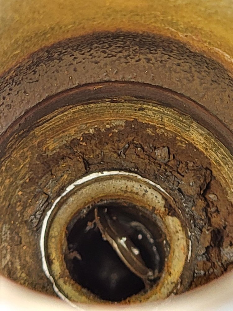

Due to a lackluster seam placement in the rangers cowl, water running down the windshield can & will make its way into the spark plug wells, especially if you park with the nose pointed downhill.
In some (lucky) cases, a simple misfire is all that will occur. Ford's official fix is replace plug, replace coil/boot, goop up with dielectric grease, and install the very engine cover they deleted from the trucks after MY2019.
In extreme cases.. the plug will be so ridiculously corroded that the repair ends up being a complete head replacement.

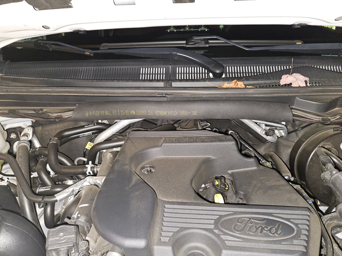

The community has also figured out that putting a piece of foam pipe insulation across the cowl covering the seam will keep your wells nice and dry regardless of the weather.
I would personally avoid the engine cover, and go with the pipe insulation... as engine covers where I live do nothing but give rodents an extremely appealing place to live. YMMV.
