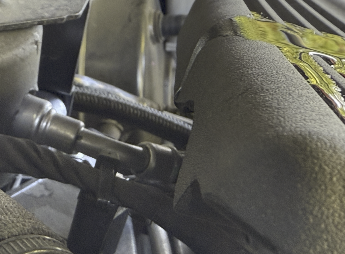

As bought up earlier in the thread.. the easier&cheaper option is to just slip a peice of pipe insulation across the cowl.

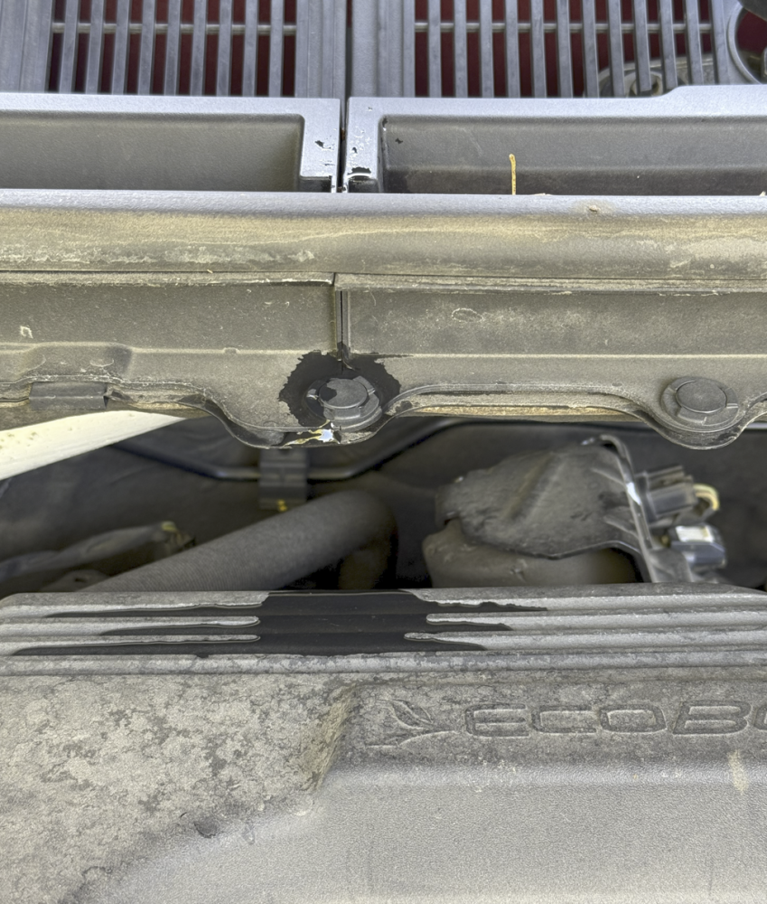

My 2019 Ranger Lariat does have the engine cover but the engine cover does not keep water from dripping from the windshield onto the spark plugs. I emptied a water bottle on the joint between the two plastic screens which leaked out the seam below onto the engine cover which then overflowed down the back of the engine cover into the valley containing the spark plugs. This is with the truck nose down. I was changing plugs at 67kmiles to (hopefully) solve a random misfire problem (no CEL or code) and got a very rusty #1 out successfully but broke off #2 with the upper half of the plug down to the wire tip coming out in the socket. I was able to use a #5 screw extractor to remove the rest of the plug but it was a very dicey operation. I'll check with my extended warranty provider to see if the dealer breaks one of the remaining 2 plugs will having the head removed or replaced by covered. So, maybe the split pipe insulation is the most effective path forward. Knowing what I know now I wouldn't buy one to fix this rusty plug problem.
Forgive me but I'm not clear on where this pipe insulation is placed (and the size of pipe insulation). Are you placing this the entire length of the hood, or just about the Valve Cover area?
Thanks for any clarifications you can provide.
