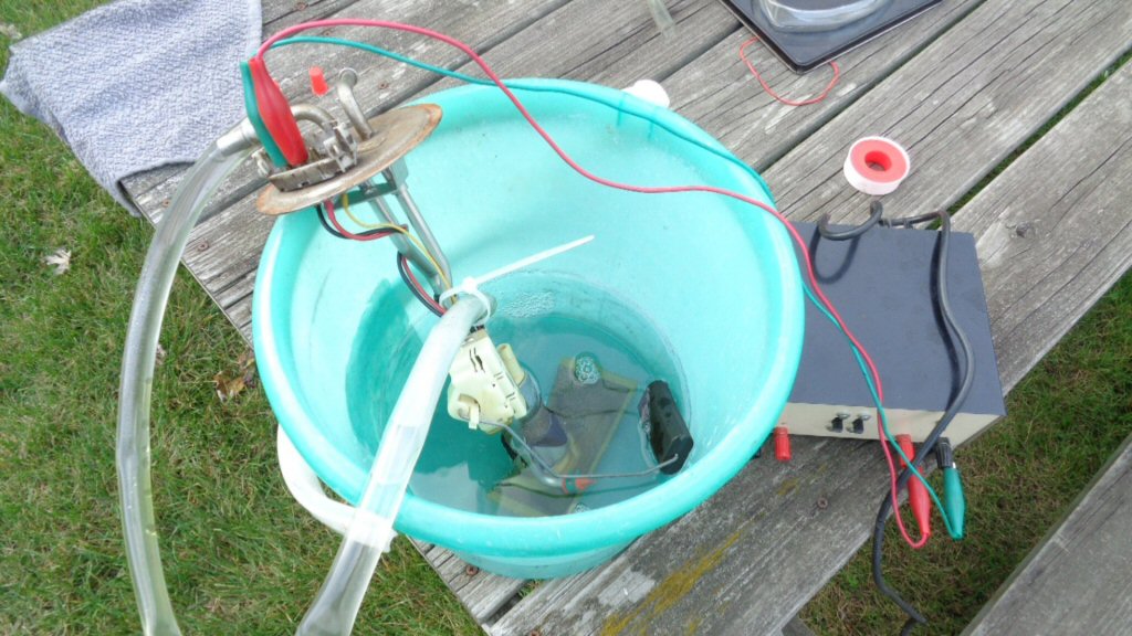

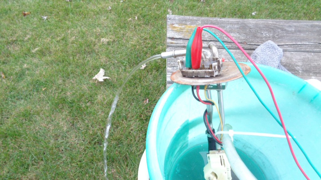

I took the old fuel pump and connected it to a 14V power supply with a hose connected to the pump output. I then put the pump in a bucket with water. I let the pump run for a while and recirculate the water. After about 10 minutes the pressure dropped to very low and you could hear the sound of the pump sporadically fluctuating. It would occasionally stop and then start again. see the attached pictures.
In the second picture you can see the water coming out pretty slow. When the pump is cold, it pumps out a lot more water. It looks like the problem is heat-related. When the pump heats up, it starts messing up. I rigged up this test to confirm the old pump is bad before I take the Ranger out again. It sucks being stuck on the side of the road.
When I checked the pressure with the new pump installed, it shows about 40 PSI after turning the key on but not starting the engine. With the engine running the pressure is about 33 to 34 PSI.
