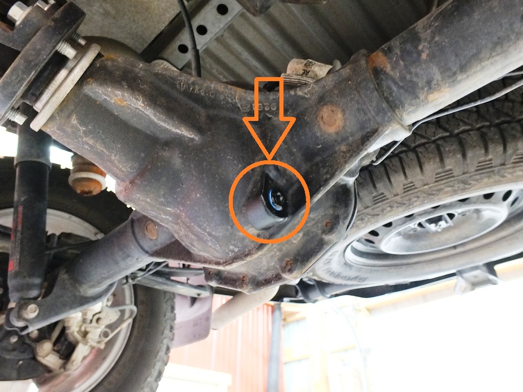

I changed the lube in rear differential on our 2019 Ranger today. One thing I found was the drain plug and fill plug on the rear differential weren't tight?
Then I checked the front differential: the drain plug was tight, but the fill plug wasn't?
The argument could be made that they are pipe threads and that "tight" is just my personal opinion. But fact is... they weren't all tightened from the factory the same amount.
I'd suggest checking the fill / drain plugs on your front and rear differential. Snug them up.

I stuck my 3/8" Craftsman ratchet in the square hole in the plug... and the weight of the ratchet spun the plug. My truck only has 7,500 miles, but I'm sure glad I changed the fluid.

It had a fair amount of fine metal stuck to the magnetic drain plug. That's not really that unusual since these gears "wear in". I just like to drain and refill the rear diff. at the 2nd oil change.
