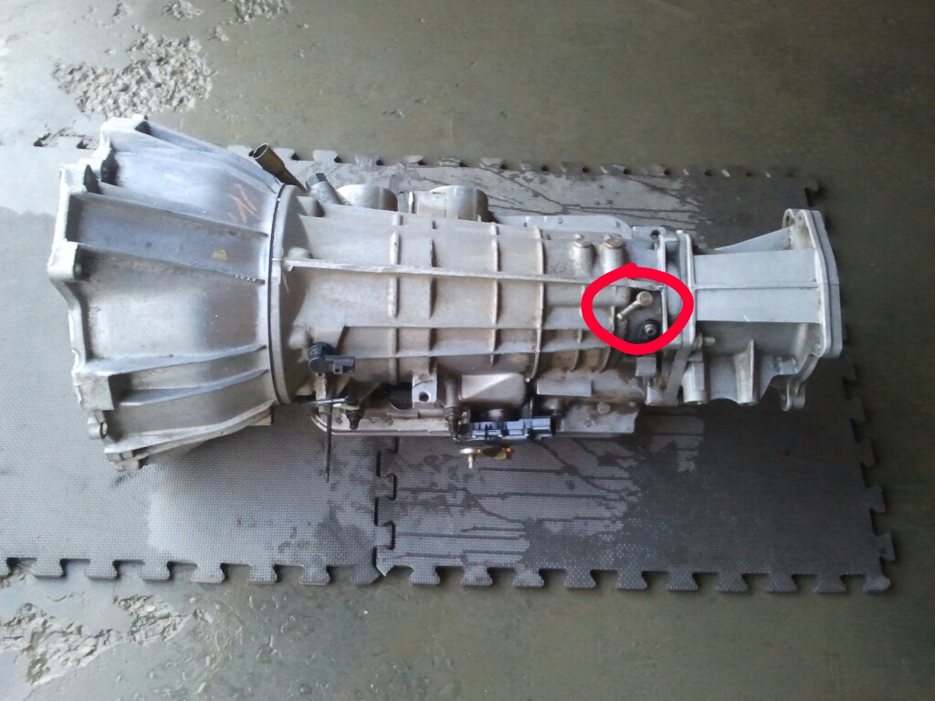

Is there a link to a diagram that could pinpoint where the vents are located just so I can try to match up with what I see?
Thanks for the help.
There is only one vent
Circled in red, sometimes they just have a cap, sometimes a rubber line is attached.
