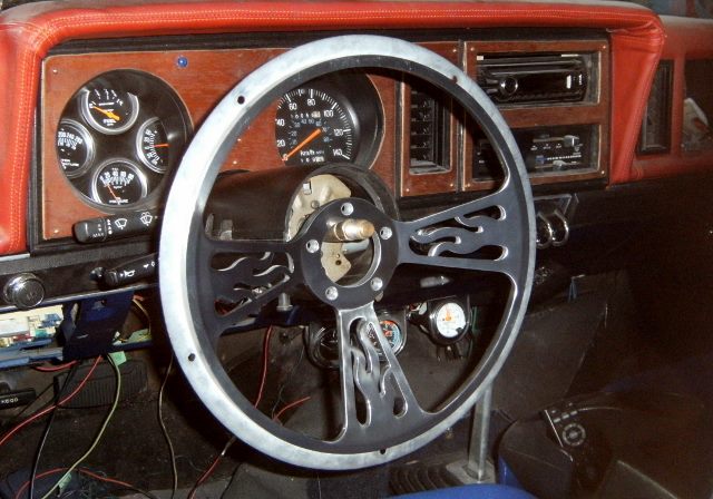

Should be nice, interesting gauge set up :)
Newer actuator arms are plastic, so broke more often, and these are usually part of the Locking steering wheel mechanism so with custom wheel you may need to modify it
thanks for the compliment on the gauge set up. took a couple weekends to figure out what to do there a couple years back.
the wheel has a kit that angie had to get separate for the ford. i want to wire the horn in as a (-) ground wire to activate the horn. shouldn't be any troubles there right?
can you explain a bit more what you mean about what could break on the arms? I can't remember if the steering wheel locked back when it was on the road. (been a few years now) but seeing the light for this truck being finished this winter/spring... (i hope)

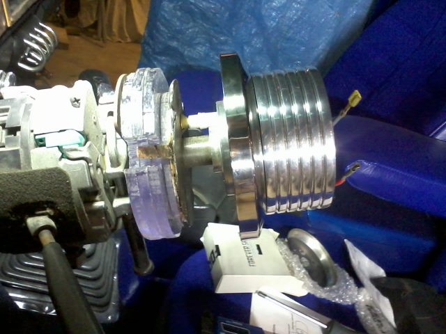

Thought about this over weekend and was able to come up with a solution. took apart an old glass tube style fuse holder and the size was a perfect fit into the "hubs" pass through hole. attached spade end on it, made another wire spade end to 1 of the 3 bolts that secure the spacer and hub. this will give the ground to the push button from the steering shaft. placed a brass bolt into the fuse holder and the spring from the holder will apply enough pressure to the bolt. the bolt will be hitting a circles metal plate i will be cutting over the week, then mounting it to thickened plexiglass backing i will build. this baking plate will be bolted to the guts of the turn signal holders. there is an area already there to work with. will rivet the plate to the plexi and strong glue the works. will need to weld another male spade plug to the metal to complete the circuit and that wire will go out to ground at the horn.
pic gives an idea what i am up to.
cheers

in case any one gets into this spot.... metal can't touch the main shaft, so i took plexi plates i have around and made these collars. and the pin for the spade is from the steering wheel of a 88 parts truck i have. i soldered it to a cut saw blade that i had laying around. used a plasma to cut a circle. then megga soldered it to it. the brass bolt head that is pushed in is in an old style glass fuse holder.the spring in the holder will keep constant pressure on the saw blade as it spins around. these plexi spacers measured out to an inch and are bolted solid to the guts of the innards from the column switches. a litte bit of doing with dremmel, files, grinding wheel and drill press today. but got it figured out and will work. i will put some electric contact grease on the head of the brass screw when i bolt it fully together to give it some slide.
after searching around the net i found that painless made a remote push button switch for aftermarket steering wheels... but i think they are now discontinued. dang... would have saved some grinding dust today.
oh well.
cheers
