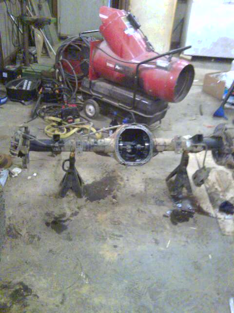

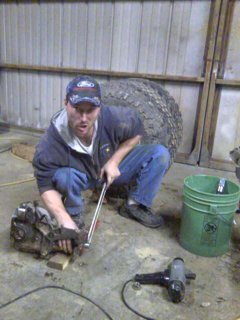

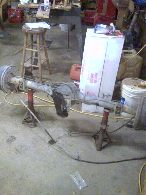

Bad week gone worse...But as always, RangerSVT got me back home. Here's the carnage report...the carrier bearing went, causing the dshaft to jump around, throwing the u-joint at the diff, and breaking the flange. Thanks to John, got that back together while I was in surgery on Frank's truck. Now the worse news, John found slack in my factory blocks between leaf and axle, come to find out the lift block was riding on the outside edge of the spring perch, which wore the spring pad pretty bad. Now if that wasn't bad enough, I found a broke u-bolt on one side, so it looks like saturday is the day I go back into surgery, this time on RangerSVT. But rest assured, it wont take long to fix, and it will be ready for the trail, at least in prerunner mode (still no front drive)

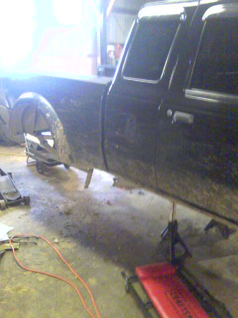

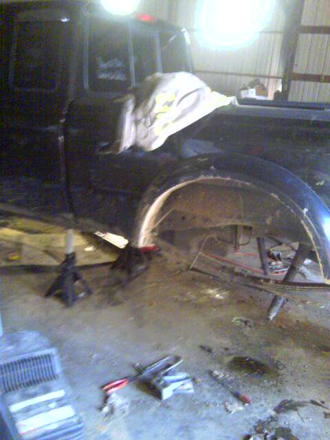

Here are some pics from Frank's truck in surgery...
