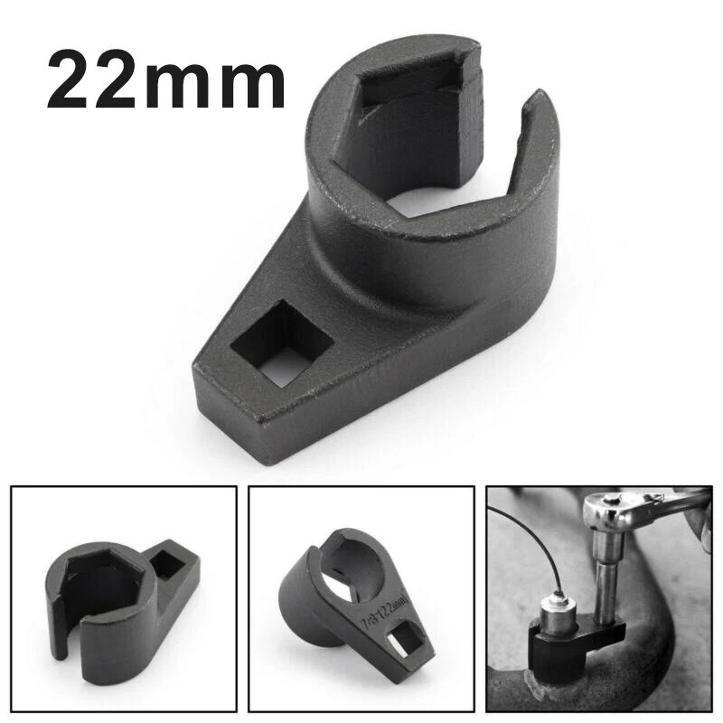

The crow foot O2 sensor wrench is a good one to have, like this: https://i.ebayimg.com/images/g/FSYAAOSwgmpjdXHr/s-l1200.webp
Because you can use it from under the exhaust pipe, to loosen the O2, as space can be tight and a socket just won't fit
