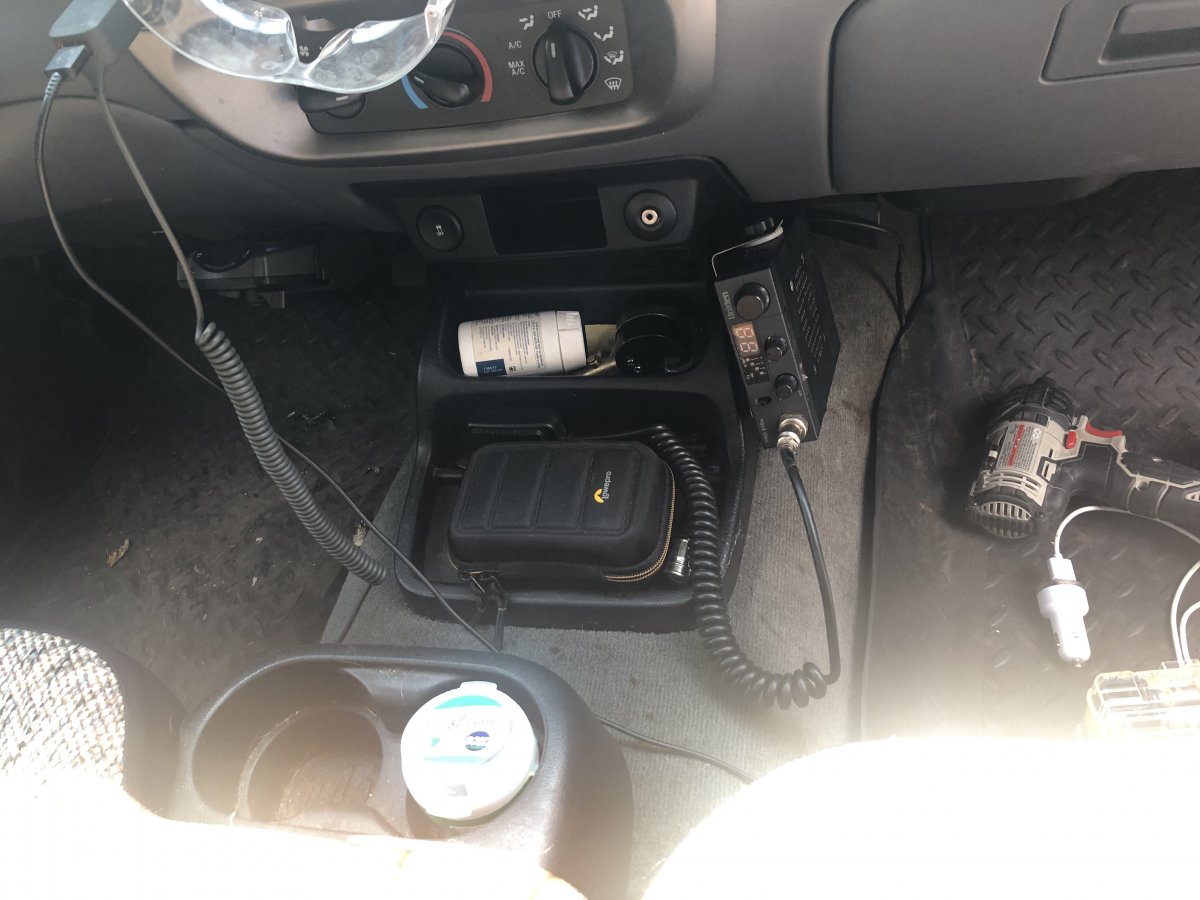

I've yet to install my Uniden PRO520XL but the time is nearing and I too want to best bang for whatever I put in my truck.
After 10-15 years I finally got my cheapie Cobra put in my truck, I have enough going on in my truck I don't have much room for any other options.
I really don't like how my Cobra intrudes on the passenger side, I will probably relocate the mike but I still don't like it all the way over yonder. But I don't want it to trade places with my gauges... or my cupholders.

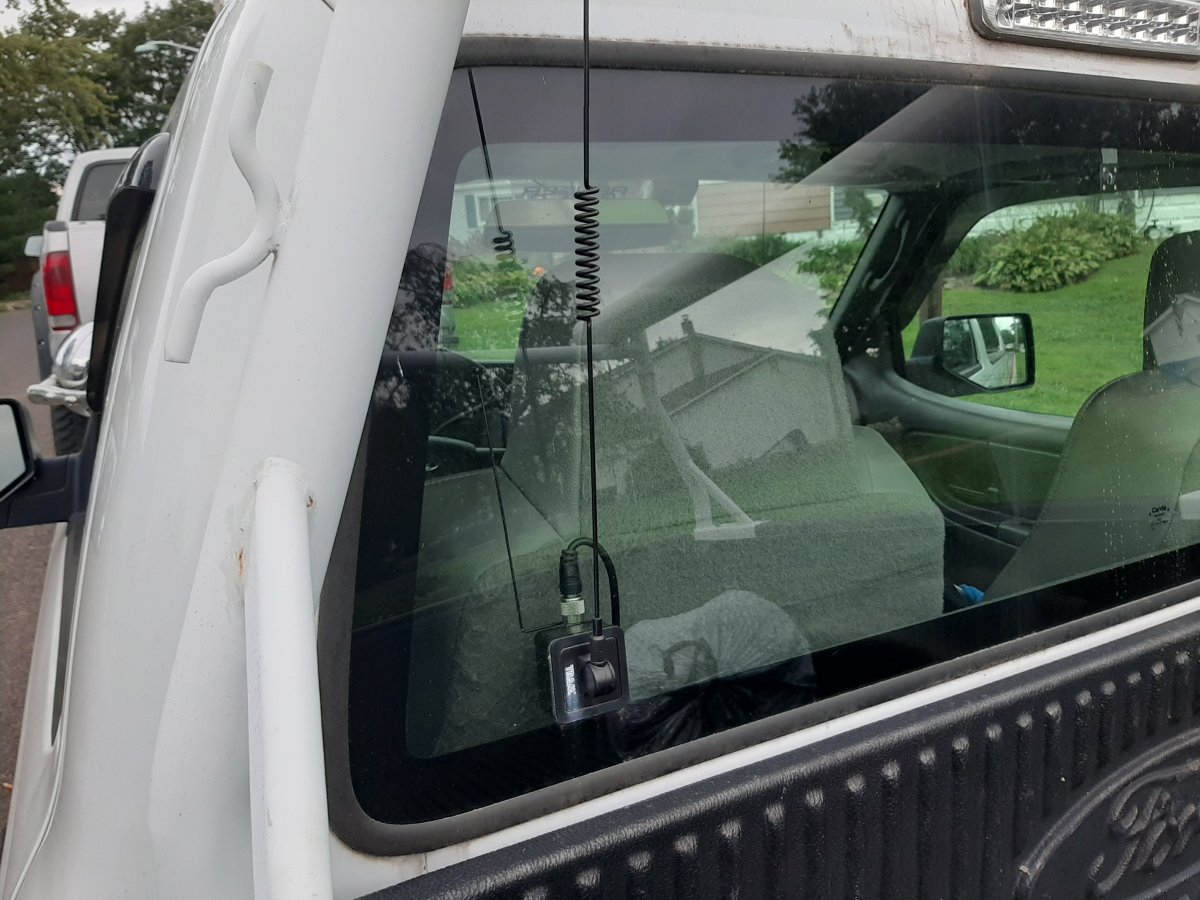

My antenna cable for my GRMS is a standard PL259 connection used on CBs. I just use an adapter to reduce it to an SMA connection (what my radio uses).
This is all my antenna is, this lil guy does the job just fine. No giant whip required. Sticks about a foot over the cab.
