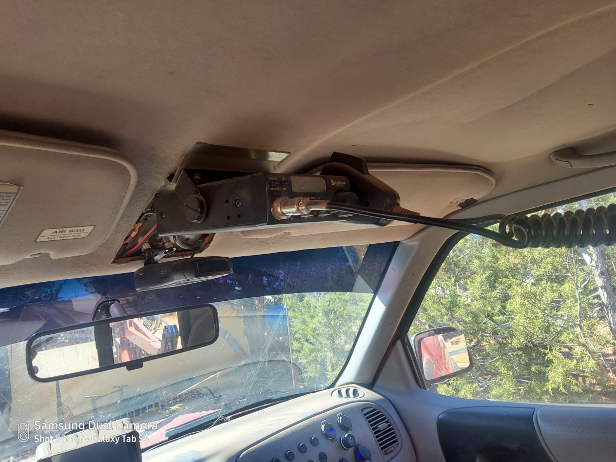

How you power your CB depends on how you use it. I have mine wired directly to the power, that way I don't have to use the key when I use it. As far as mounting it, I have mine above the rear view mirror. Heres a picture.
