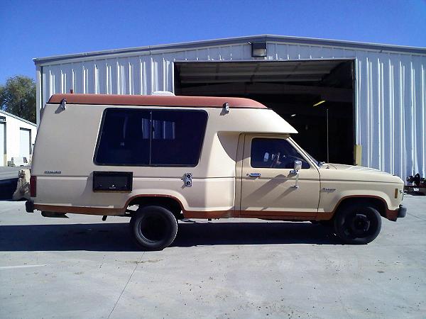

Cant be heavier then what some company used to saddle 1st gens with...
