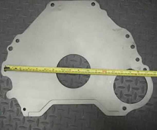

302's used a 140 tooth flywheel in Mustang II's, otherwise they use either 157 or 164 teeth. The bellhousing and block plate have to match. The measurement shown would be16 7/8" on a 157 and 17 5/16 for a 164.
thanks for the measurement info looks like the trans i got it for a 157 tooth and i checked my block code and its an 79-84 out of a car. which looks like it has its own problems with a two piece main seal. I kinda did this swap on whim just because the engine was complete and so cheap I might just clean it up and re sell it for an attempt to get a newer one, or just get new heads, intake etc. I'll be doing the rear end swap next summer and this swap the following.

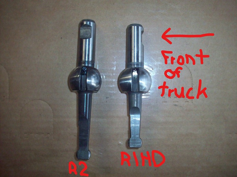

Looks like it'd be the same process. I almost wanna try it. Should be easy enough to reverse if it didn't work out.
Edit: I just noticed the ball end on that. My lever has a kinda wedge shaped end. Honestly not sure it matters or couldn't be modified.
yeah would think if the ball is same size at the end could just grind to a wedge thickness.

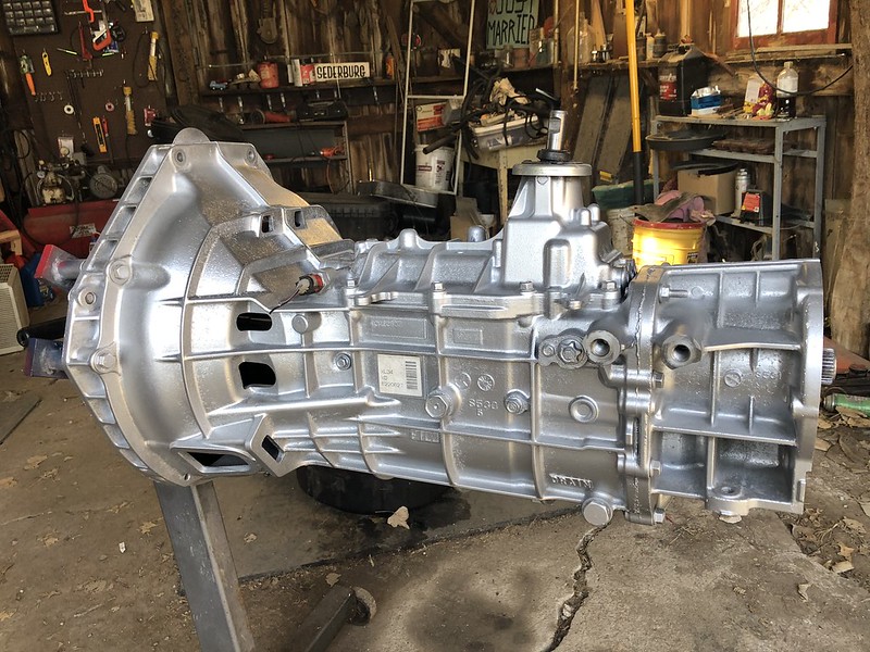

Im doing the swap in a currently auto ford ranger and switching to the manual R2. will I need a new spline for my drive shaft? (i assume yes) and will one from a manual ranger that had an R1 work?
It just popped in my head this morning and been googling and searching for few hours and cant seem to find any definitive answers or mentions in peoples swaps concerning even the drive shaft length let alone the slip yoke for 2WD, theyre just about putting it to a transfer case which doesn't concern me.
