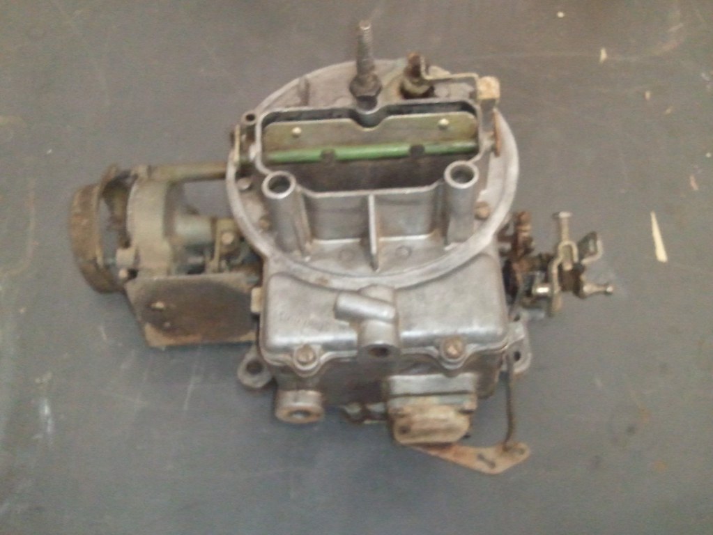

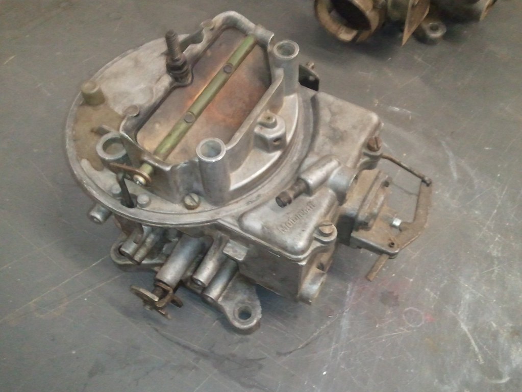

When I bought an 84 BII it came with a couple boxes of parts, of which there were three carbs, a 4 barrel and two 2 barrels.
The BII wasn't running and had a half complete Duraspark conversion on it and I'm now working on getting it finished. It now starts and runs briefely (no more than a minute yet and will barely idle on its own). I'd like to rebuilt the carb but it still has the TFI feedback carb on it so I'd like to put a more appropriate carb on it. Which brings me to the box of extra carbs. I'm fairly certain the two barrel carbs are 2150s or 2100s and are probably also in need of a rebuild. I took them into the auto parts store today to get a rebuild kit but we couldn't positively identify either of them or what they came from. We tried looking up several random vehicles from 76-83 that came with 2150s but they all have different rebuild kits!
So, my question is, can anyone identify the carbs in the two pictures so I can locate a rebuild kit for them?
Sorry the pictures aren't the greatest, they were from my phone. If anyone needs more let me know.
The first one has a 9 cast into the bottom and 1.08 cast into the side as well as 24EA stamped into the side of the base.
The second one has a 7 cast into the bottom and 1.08 cast into the side as well as 30EA stamped into the side of the base.
Thanks for the help!
The first one I believe is the 2150 and the second one is the 2100. The way to tell is the vacuum pulloff for the choke. I was able to use the choke assy from my feedback carb on the 2150. It has the pulloff pod on the back of the carb and the preheater vacuum port is plugged on the nonfeedback choke. I didnt have the carb number but it is a 1.08 venturi pull the top off the carb and match up the float gasket is about all you can do. everything else is probably the same externally just be careful pulling out the venturi cluster if it is stuck get a gallon of carb cleaner and soak the carb 24hrs fully submerged pulling as much rubber you can off and use the right screwdriver to pull the jets but you can use the jets out of the feedback carb also.Pull the top off the first carb get a pic of the top and one of the bottom with the power valve cover off to tell if it has the 2 stage power valve.
