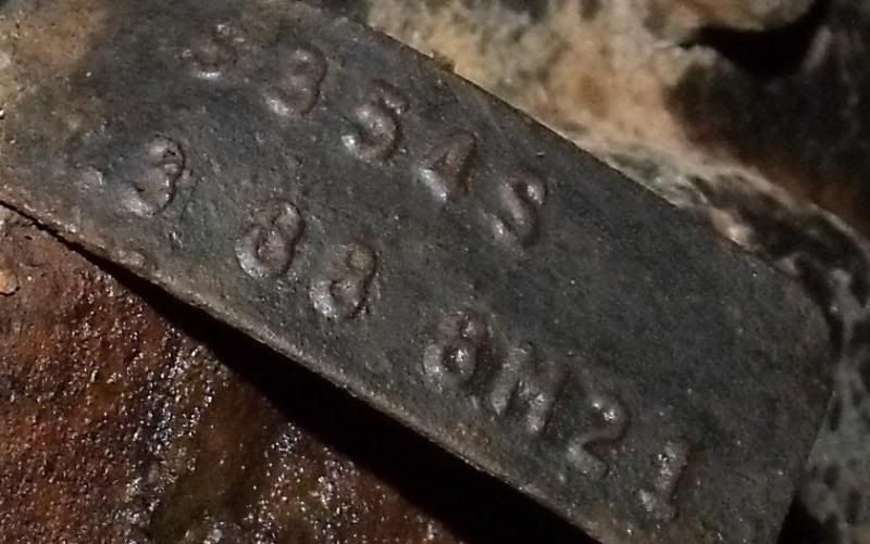

Cant seem to decode axle code
OK so I'm a total NOOB to ranger axles. So are the 28 spline, and 31 spline axle shafts the same diameter? Also whats the width difference between a ranger axle to a explorer axle? same year wise...?
