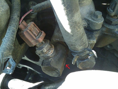

This is attached to the block just below where the thermostat is. It has a temperature sensor screwed into the top and it "had" a nipple on the bottom for a host that ran to the coolant return hose.
The nipple coroded and was spitting coolant all over my engine compartment. I thought it was the water pump so I replaced that. The ford dealer gave me some BS line about having to buy a new thermo housing to get that part, but that just can't be true.

It is an octagon shape part screwed in to the lower part of the housing where the thermostat goes. It has a 3/8 screw into that housing and the temperature sending unit screws into the top with a 3/8 thread.
The bottom nipple that is missing connects to a hose that goes to the lower coolant return hose.

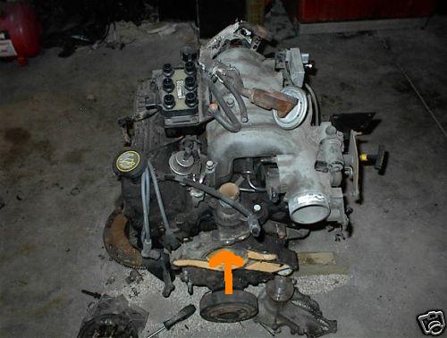

The orange arrow is where the part I need screws into. My engine is a 3.0L

the nipple is trashed. You won't be able to recognize it. It is about 1" long with a bulge on the end for a hose to fit. It is about 3/8 OD.
Made from a very thin metal, looks like it might have been pressed into the octagon block.
