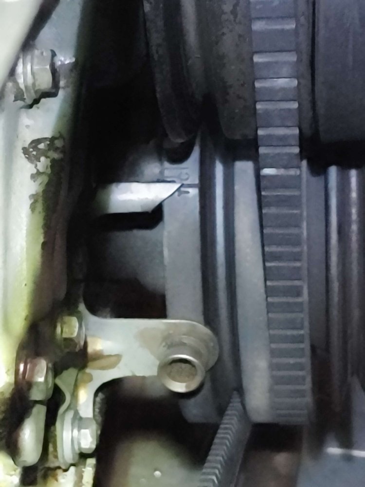

Sorry for posting a new question almost every day, my pile of junk has a lot of problems. Anyway, I put on a new intake manifold gasket, put the actual manifold on, and then when I go to put the distributor in, it refuses to go in. I marked out exactly where it was when I pulled it out, and trying everything from pushing on it, turning the rotor, and even rotating the engine very slightly got nowhere after trying for an hour. It stops a little under 1/2 inch from the O ring. I looked down the hole and it seems like the spline it goes on isn't centered. Is this normal?

I did that for cylinder one and am pretty sure I stopped it at TDC. It still refuses to go in further than barely on the gear no matter what direction I put the rotor at while at TDC. Just to confirm, this is TDC, right?
It is TDC...
