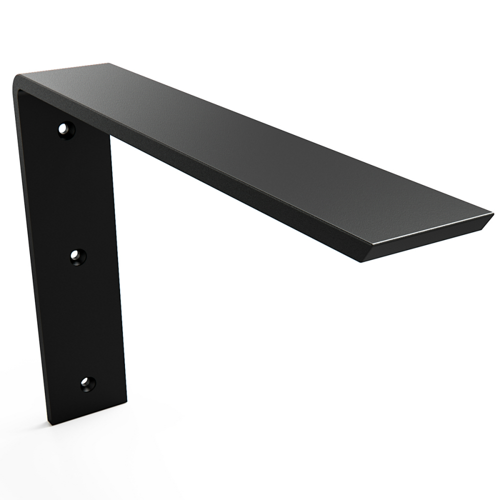

Not to change the subject but what do you guys think about this for bracing the corner?
Its for granite countertops....ill also run the angle iron under it and use washers to make everything even, obviously ill be using it in an L shape not the shape the pic shows it postioned) It dont have a weight rating (that i can find) but its 1/2 in thick and goes plenty deep enough to get the front of the bracket up into good steel (about 12 inches...these go up to 16)
You really shouldn’t need anything thicker than like 1/8” steel for anything on an RBV except maybe frame components. Also trying to join thick steel to thin steel doesn’t always go well.

Im going to use bolts for this little adventure. Mainly because i want it to hold up a while and i dont wanna have to redo it in a year after i realize i didnt practice my welding enough lol.
