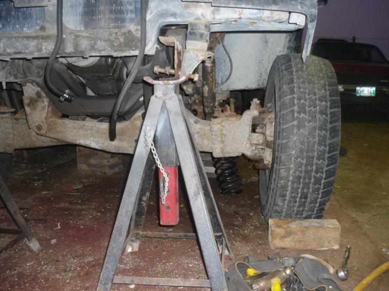

Ranger rear TTB
S10 front TTB.

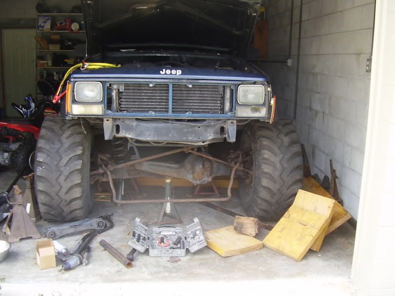

XJ TTB front.

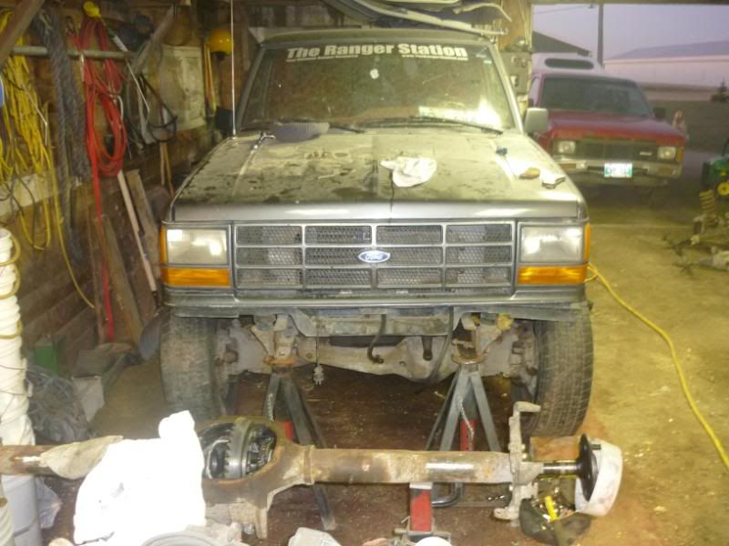

One I'm working on.
