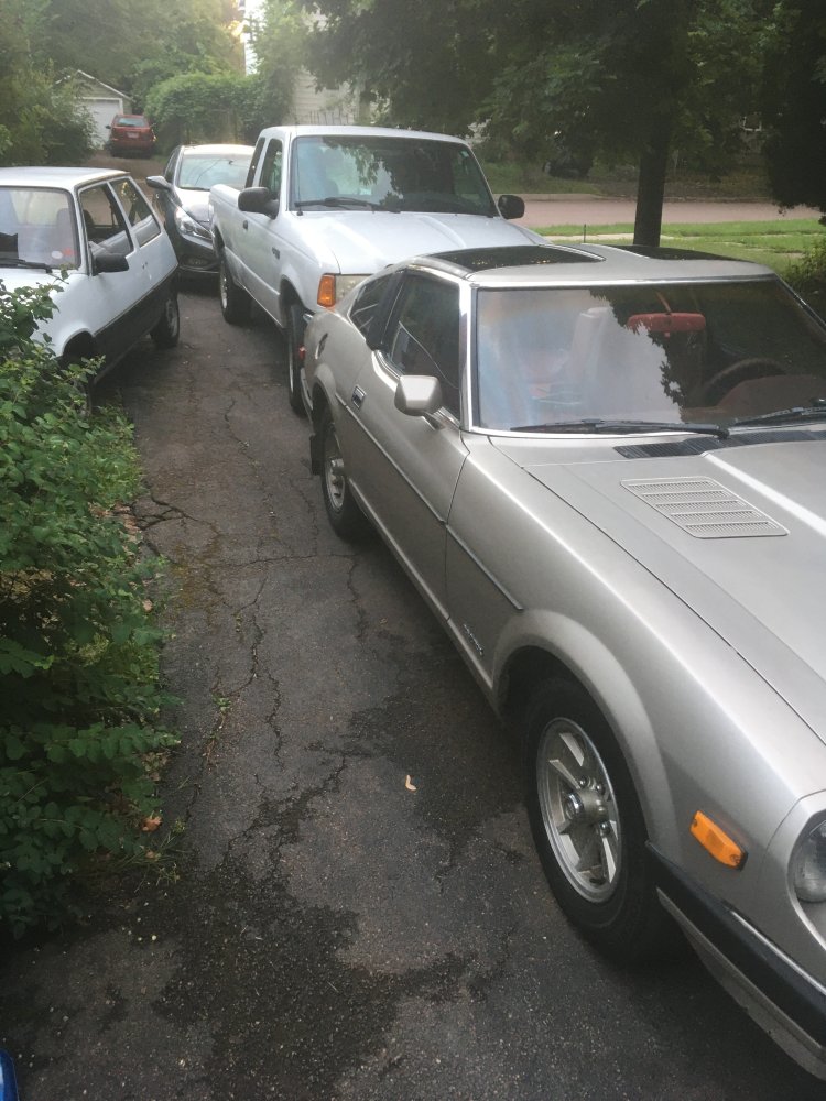

Having to remove a wheel to do an oil change is nuts. Reminds me of the Chrysler "cab forward" cars from 20 years ago that made you remove a wheel and the fender liner to change the battery. To do the same for an oil change is even worse. As a Datsun fan and owner, I had already ruled out Nissans based on the CVTs alone. 😔
I'm curious about yuor Datsun. What is it?
It's an '82 280ZX. It was headed to the scrap a few years back due to being essentially mechanically totaled (mostly blown up transmission) but I snagged it and I've brought it back to ship shape since then. Still needs some cosmetic love...

For some reason I cant see the pic . . . ;)
There's the old girl.
those are fun cars. even the automatics are a blast to drive. my brother had a few and loves them.
