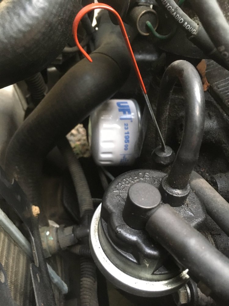

Looking from above. Looks just like your photo. Left side of photo is where the clearance is going either up or down.

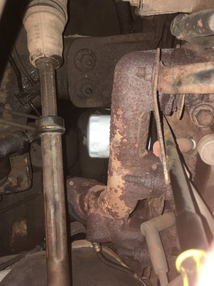

From below. The picture really doesn't show the worm hole that is available. But it's there.

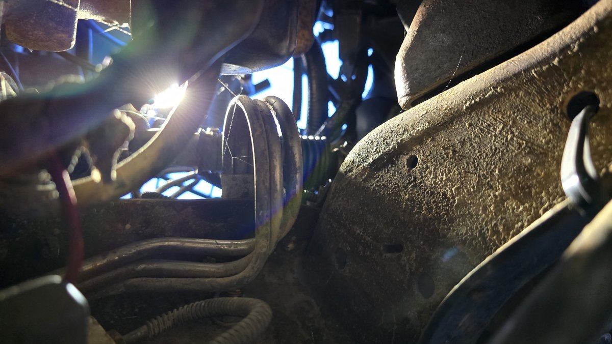

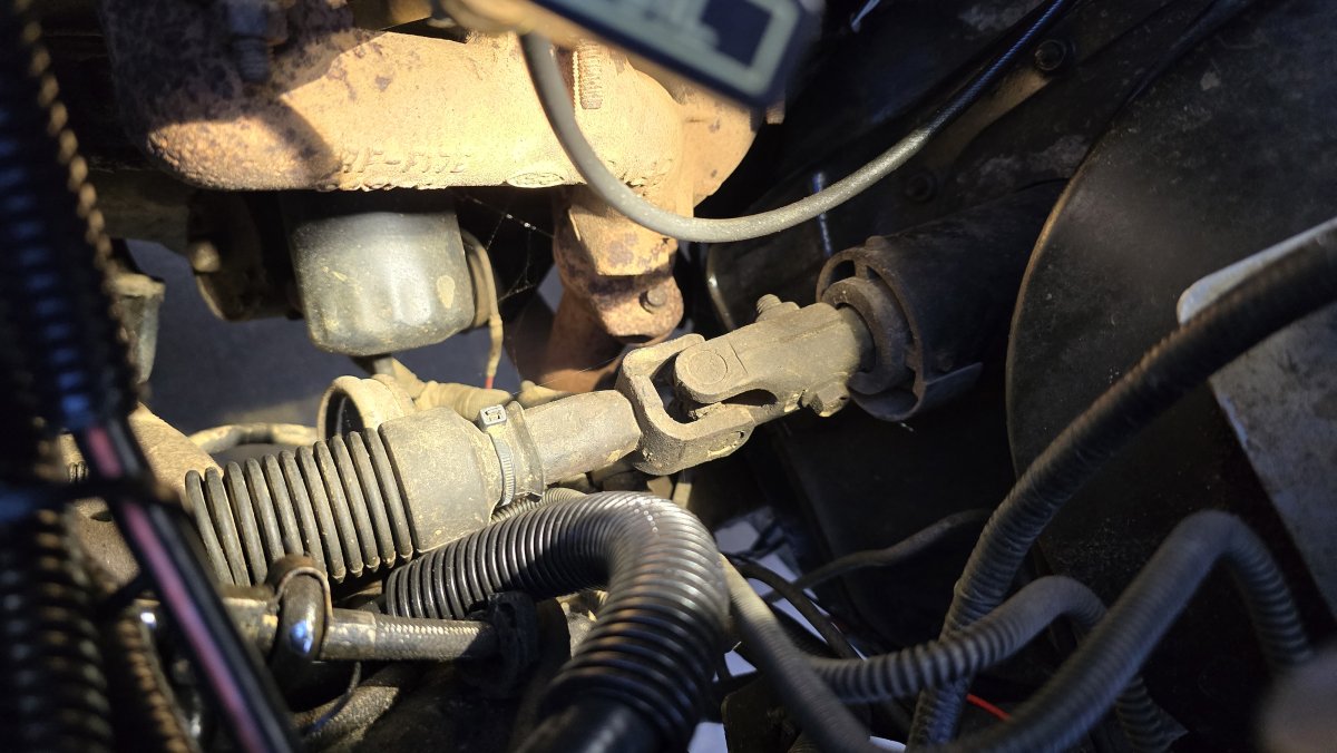

Hmmm, I must be missing something because I'm not seeing what you see. My steering shaft looks different than yours. It looks like you have a u-joint close to the firewall, I don't have any near there.
You have a boot right in front of the filter but I don't.
Your steering u-joint is right next to the manifold dump. Mine doesn't look like that to me at all.
