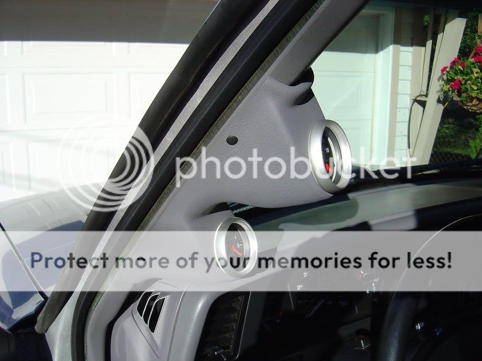

I am thinking about mounting a volt and oil presser gauges on the A pillar.
