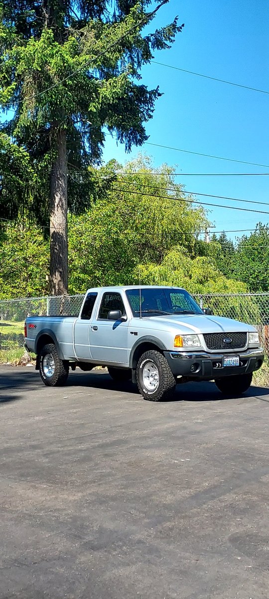

Can anyone see that my passenger front door is a different color than my ranger ??

If you can see the color difference why do you think the color is different and whats your thoughts.
I paid for a carfax report and it showed no accidents. One of the owners in that rangers time did not report the damage or accident, collision.
My uncle my dads brother could see the difference and said it could of been maybe someone bumped a shopping cart into the door its hard to tell exactly lol

It does look different in that photo. Could be some minor damage was repaired. Not everything gets reported to insurance or car fax. Only way to really fix it right is to get the whole truck painted. Not worth the trouble in my personal life.

How does it look different to you in that photo. What would the minor damage been maybe ? and how do you think they repaired it ? Why does every thing not get reported to insurance or car fax. I don't want to get my whole truck painted. I will let somone else do what they want with it someday when i sell that ranger.
There is no requirement to report to insurance or Carfax for minor stuff. If your deductible is $1000 and it costs $200 to fix something why would you not pay for it out of pocket?
It appears to be a slightly different shade if the same color. As if it had been repaired and repainted or possibly might even be whole replacement door. As vehicles age, the UV rays of the sun slowly fade the paint. Then, if a portion is repainted, that part is usually darker. Same if a door from a garage-kept vehicle is placed on a vehicle that has spent its whole life in the sun.
Granted, this is all guesswork based on one picture taken from one angle. Another picture from a different angle or in different lighting conditions may look totally different. So, we can’t say for certain that it is or is not different. We’re just guessing based on what we see in that photo.

About the OP, respraying a door is common after repairing minor blemishes or dents in that door. That's probably what happened.
Yep. For sure repainted. Not much you can do now except get the whole truck painted or live with it. Silver is one of the hardest colors to blend

If the rest of the truck is the original color, you could take that color code to a good paint store and they should be able to match the paint. A lot of the better paint stores also have an instrument that they could place on the fender and it will read the paint color and tell them the code.
If there is sun fading on the truck, a good paint store should still be able to match that color almost exactly. Then paint the door, but feather it onto the fender in front and the bed behind. If you’re not familiar with feathering, you spray the door solid, but then the guy doing the spray extends the spray over to the next panel, but he goes lighter and lighter as he gets away from the repaired panel. If the paint color is pretty close, it creates a fade instead of the sharp edge of the door, and in a lot of cases, the difference will disappear. I would not recommend getting a spray gun and just trying it if you haven’t done it, but it should be pretty easy to find somebody old School who’s done that kind of repair. I’m talking about a buddy with a gun, not a body shop..

Silver is a very hard color to match, especially if it is a metalic paint. There could have been a door ding or the door got replaced and when the door got repainted, they got close but not perfect.
