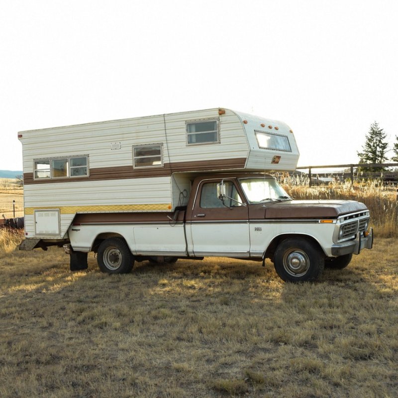

How about this rig from the 60's.
Don't think my 2.3 could handle it, but a Ranger with a 4.0 and some added heavy duty springs might be able to.
;missingteeth;
