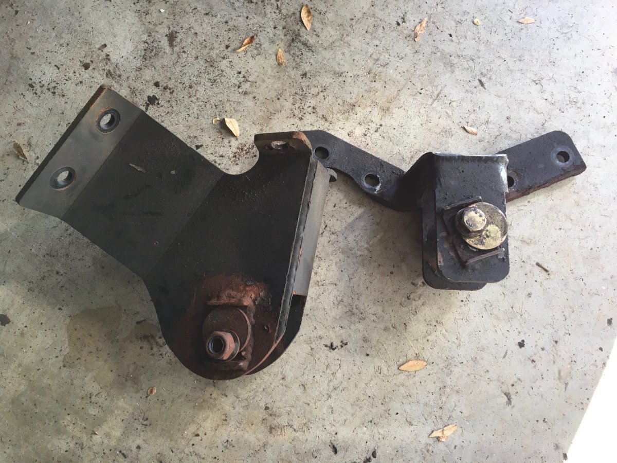

There are some companies that make axle pivot brackets for lifts smaller than 4" to correct camber issues. Tuff Country is one of them. I have a set of these for sale, they're for lifts in the 1.5-2.5" range, although I don't remember who made these. I ran these with 1.5" leveling springs, and you could probably even add one of those coil spring spacer leveling kits underneath and get ~3" of lift with these and still be able to get the alignment in spec.

oh cool how much are you asking for those
$100 or best offer. I have all the bolts for them too. You may or may not need drop brackets with a 2" lift, but it seems that every Ranger is a little different. Some people can put leveling springs in their truck and be set, and others end up with excessive positive camber that can't be adjusted out. That's why I then got these brackets. But you may or may not need them, and you really won't know until you put taller springs in.
