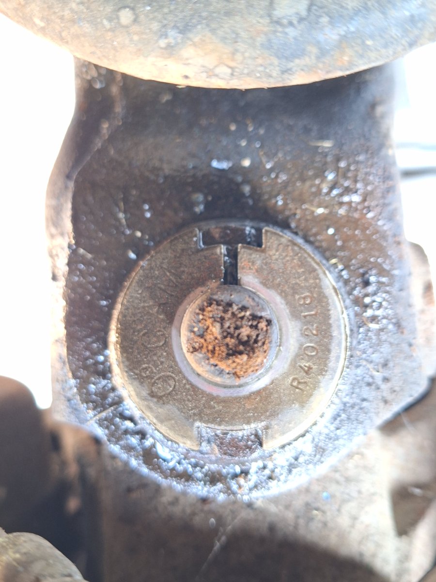

Hello all,
1984 4x4 ranger. Added 1.5" coil spacer lift. Left side camber now close to +4.° , right not as bad at around +2°. Also lost couple degrees of caster. Bushing in now are zero° direct center. Want to use moog style double sleeve to dial in, but the ones I'm finding for my Ranger only go to -2.75°...,leaving me a little shy of where I need to be. My ride height is good. I see some 3.2°, 3.5°, and 4° options out there, but for later year Rangers(pinch bolts style?) or earlier 80's F150"s (D35?), etc. Anybody know of bushings that fit D28 castle nut/knuckle lugs style like mine, that give more than -2.75° to get me back in alignment?

I'll be removing a few washers to bring front down enough for adjustable bushings to get back into proper alignment. Question, is it odd that positive camber after 1.5" of spacer on both sides imparted about 1.25° more positive camber on left side compared to right? Also, I did install larger 31" Toyo open country r/t tires at same time as level lift. Thanks guys!

More camber on the driver's side makes sense. that is the shorter beam.
I used stud extenders to increase threads for more spacer. Used large washers method...just sounds like I over did it. I'll be removing a few from each side for 1" spacer, and about 1.5" actual lift. Which I hope will allow adjustable bushings to work.
