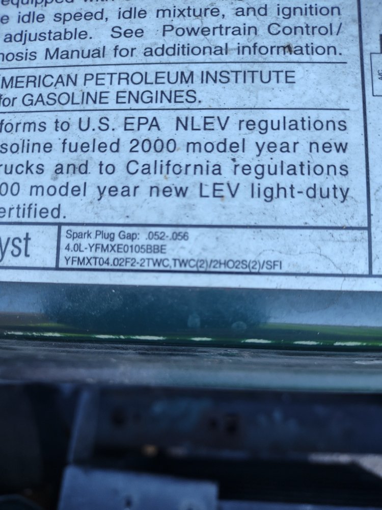

I have a 2000 Ford Ranger and trying to figure out how many catalytic converter I suppose to have. Cause mine has 5 and that is too expensive and it's so old and has holes in one but no check engine light...

Yes but a 2001 version 1FM-YFM. But too me someone I bought this used put federal emissions instead of carb compliant or I don't know...

Since the portion of the sticker you posted seems to show that it conforms to CA emissions, the parts should be CA compliant.
That is the legal answer, if all the information presented is correct.
We are not allowed to provide the less than legal answer to protect the owner and the forum.
