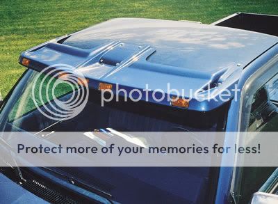

We all know that Lund used to make a windshield visor for the 98+ rangers but since discontinued said product. Well, I'm looking for a cab visor for my 2005 because I like the looks and the winter it keeps the frost from consuming the entire windshield in the morning. When I owned a 93 4x4 I installed this cab visor sold through summitracing...
Cab Visor fitment: roofline differences between 3rd, 4th, and 5th gen
It fit surprisingly well and did its job. But, I should have taken measurements of the cab and visor before installation because now I need to know this. If possible (minor trimming or fitting) do you think this visor will fit onto a newer gen ranger? I'm trying to look up windshield differences and cab width differences. I've searched for differences between the doors (primarly how it curves or transitions from roofline to the pillar) all in hopes of finding a definitive difference or similarity with no luck.
Anyone who happens to own both a 3rd gen and 5th gen ranger it would be much appreciated if you could take a simple measurement of cab width above the windshield where the visor would mount. I see a lot of posts inquiring about a cab visor for newer rangers and I'd be willing to write up a document for the tech library for future guys if this works out.

I've got a '93 and an '06 and i'm about 98 4/5% sure they're the same. I'll measure when i get home.
You the man! I appreciate it. Someone who can dial in their answer to be 98.8% correct :shok: surely knows their chit. I'm lucky if I hit 50% most of the time :yahoo:
It's dark and raining but both measured 50" from outside of A pillar to outside of A pillar. I'd have measured more for you but its cold and raining.....
I think that was the critical measurement. Everything else appears to have the same curvature comparing pictures online (or its so close I can't tell). I've got a few other goodies on the list that take priority but I have added the visor to the list of things to do over winter.
Thanks!

So the overall census is that the older gen visor will fit on a newer ranger? I can purchase one and was just double checking the end result here quick. Thanks.
My son found and bought a new Lund Moonvisor and installed it on his 2009 Ranger and it fit perfectly and all instructions were perfect also.
