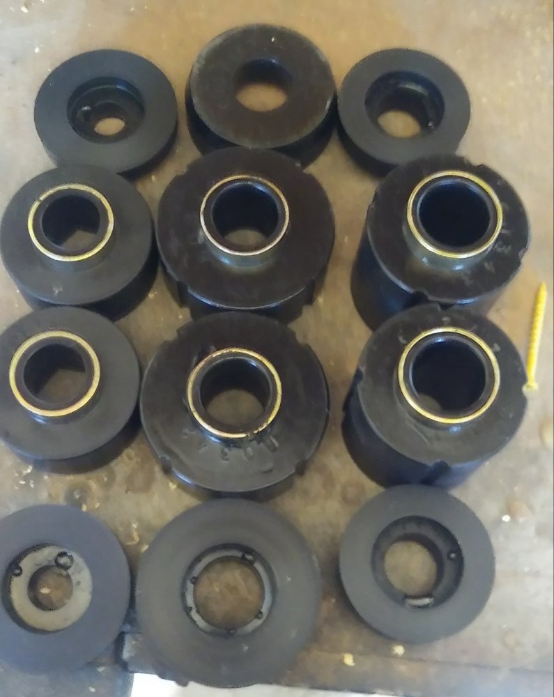

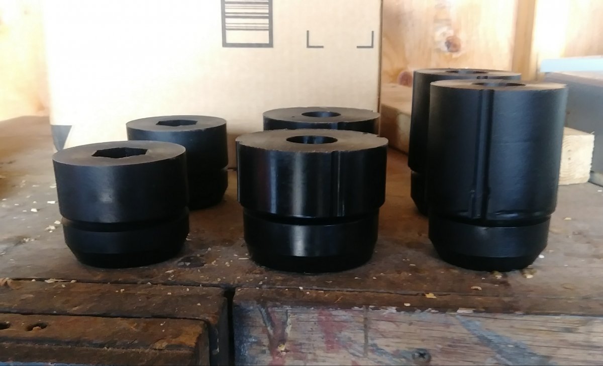

Got the prothane mounts, he's been kind to me lately if I bring it in when they aren't jammed up.

Regulation nhl pucks are stronger and will Outlast anything you can buy from the store that bolts on. I have destroyed 3 nylon 3 in lift pucks and still used the same nhl pucks on top.
So new urethane mounts with a nhl puck likely work good but also probably not needed.
The bigger issue is the base steel of the cab mounts themselves....I usually have to weld new metal in. Or shortly after because the urethane is stiffer and wastes the deteriorating metal quicker.

The very front underneath the radiator area mounts are the worst. Middle and rear it's more it seems about the washers then the rubber itself,

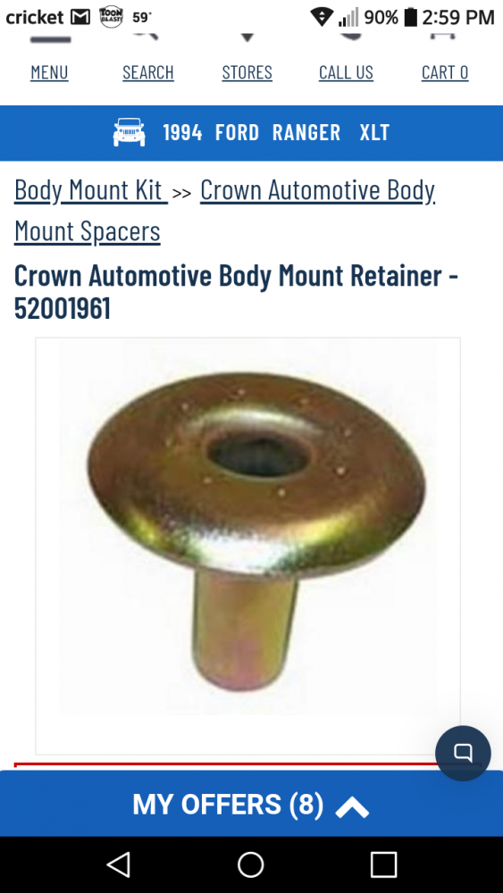

What should I do for washers use large fender washers or get a OEM style?

Depends on the cost. If OEM are expensive, I would just get a piece of sheet steel of an appropriate thickness and make my own.
getting bolts is not a problem.

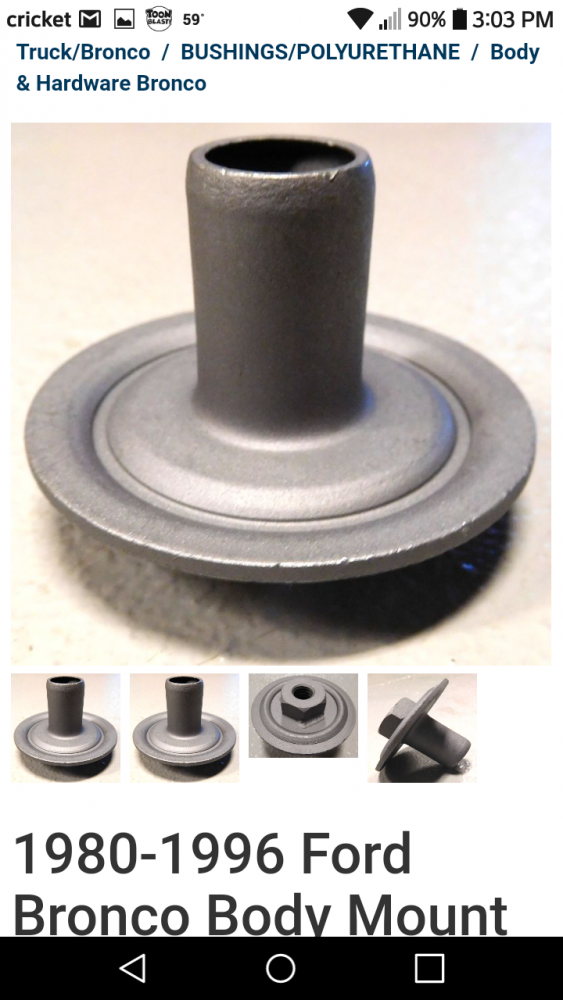

I think what I'm asking is the inside washer bushing, is that unlikely to be rusted away because it's encapsulated by the old rubber? pictures of the new ones they have a metal bushing but it doesn't go all the way through and it seems to have a 5/8 ID which if I remember right is the size of washer bushing, which also is the OD size of 1/2" copper tubing.

More sleuthing 🤔
